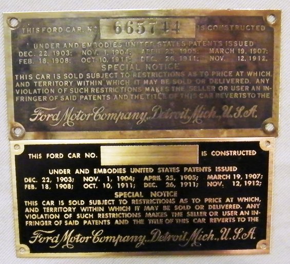

The dash tag is now the part that does not work exactly right. You can get a replacement dash tag.
You lost me. Are you talking about the brass plate on the dashboard?

Something on your car was changed over the years. The dash mounted "Patent Plate" number is way higher than your engine VIN. The easy fix would be to replace the dash tag with a number that is more believable. Here's a comparison of original VS reproduction:
Tell me more about the "FORD CAR NO" on the brass plate fellas. Larry Smith was saying the engine number is normally a higher number than the ship number which leads me to believe that the motor may have been swapped out for an earlier made engine at some point. J Franklin has an interesting theory that the engine could have been taken off line for re-machining and put in a later car.
I got to tell you, I'm pretty relieved I don't have to go looking for another block.
