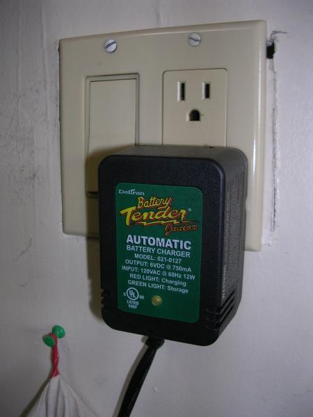

Old 07-26-2010, 11:08 AM   #5
Merc Cruzer
Merc Cruzer's Avatar
Join Date: Jul 2010
Location: Conifer, Colorado
Posts: 2,518
Default Re: 6 volt trickle charger
Got mine from Batteries Plus....leave it hooked up full time when the car is parked.
