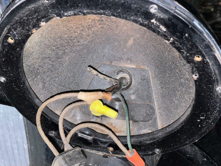

As I continue digging through electrical problems, I took apart the "sealed beam" headlights that someone installed on my Tudor. Partly because they're the wrong thing, partly because the light switch wasn't turning them on, partly because the engine compartment end of the wires was a rat's nest.
Isn't that lovely.
I want to fix this right, so I went to a couple of the parts suppliers and priced out the correct wiring, sockets, reflectors, lenses and so forth. The total is pretty close (within about 20%) of the cost of just buying a set of reproduction buckets with all the guts.
These black-painted buckets aren't actually correct for the car, I don't believe. I could probably get a set of originals off eBay, but all those currently listed look like they're going to need significant work to get into shape. And with eBay you're often buying someone else's unresolved problems...In any case, I was wondering if anyone had opinions about current repro headlights before I buy a set.

You post indicates you have more than one electrical problem. It is far better to restore original parts than to use reproductions in my opinion. In your case, I suspect that your Model A needs a total electrical system restoration, so I recommend that you replace the all of wiring harnesses, especially the main lighting harness.

Good advice, Bob. I didn't mention it, but this is part of my wiring harness replacement project. Untangling the mess has been interesting... in the ancient Chinese curse sense.

Dan, you could if you aren't already, replace the wiring harness, available at the normal suppliers. You might be able to get your headlights and buckets from Sullivan's Garage. https://www.sullivansgarage.com/

FWIW: I was having issues with the flat-headed stock-style wires and plastic inserts meeting properly with the (obviously) repro socket in the buckets. I removed the guts of the sockets and installed banana plugs on the harness wires and the socket wires, and use the push-in connectors on the wires. No trouble since. The harness wires are color coded, but the socket wires aren’t. I put a wrap of colored electricians tape to keep them straight.

Don’t know what year your Model A is, but before you drop everything to buy new, you should know that reproduction lights have been in scarce supply since Covid. Then, you also need to know that while the new buckets are very nice, the weak links are the internal wiring & sockets and hardware that holds the new assemblies together. So, in my estimation, if your buckets are sound, you’ll get away a lot cheaper to “bite the bullet”, do some research, buy the best quality wiring & socket sets available and learn how to put them together properly. You’ll be ahead of the game. Shiny new buckets don’t account for internal parts that can only be maintained with lots of cursing.

I concur. To me the weak links seem to be the repro A-13075-?? Head Lamp Sockets - contacts in the wrong places, metal too thin, metal not springy enough to hold in place, diameter of the sockets either too small for the headlamp or too big for the conduit ferrules (or both).

Thanks for that--Unfortunately, the buckets were gutted when whoever-it-was hacked them to install the "sealed beam" lamps. I have the buckets, the trim ring, and that's it--I don't have sockets, lenses, wiring, or any of the "guts" so I'm going to need new innards whatever I do about the exterior parts.
