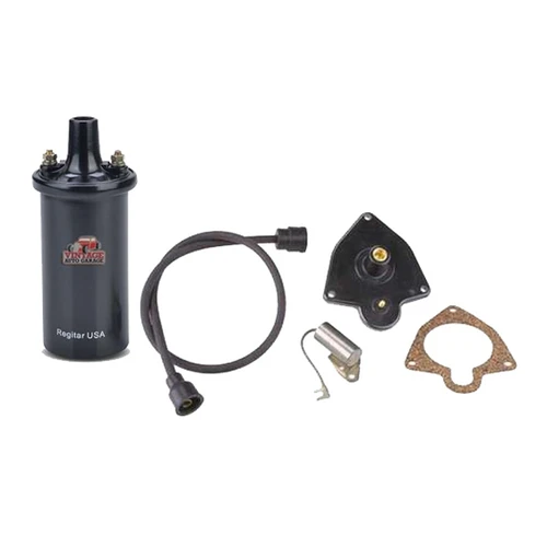

I had a beautiful 36 Tudor fall into my lap and I'm converting it to 12V. It's a 21 stud V8 and the kit from Vintage Auto Garage came with a 3 bolt coil adapter. When I went to change it, it turns out I have a 37-41 2 screw coil. That's completely my fault I'll get back with the company.
Here's my question: When I tried to remove the 2 screw coil it came loose but the silver cylinder, that looks like a condenser, was holding the coil in place, the rest of the coil would lift but it was hung up there. Is there a trick to getting it off, I didn't want to mess anything up internally. I've attached a picture of the cap and a couple of the car for good measure. Appreciate the help -

The condenser (the silver cylinder) is secured to the body of the distributor with a bolt.
The same bolt used to secure the distributor to the block...

Unsnap and remove the distributor cap for better access to the bolt.
Also, cut and secure a piece of cardboard to the engine side of the radiator to protect the radiator fins from being smashed/bent while you're working in that area...
Thanks for the assist, got the coil off with no issues, I appreciate the information. one additional question: my coil is the "newer" 37 - 41 two screw design, when I got it cleaned up I'm not seeing a spacer plate for the retrofit. From what I've read that's indicative of an engine with updated cams, is that correct? It's a 21 stud head with the water inlets at the front.

"spacer plate" ??? Got a picture?
Adapter Kit installed as seen below...
Adapter Kit
1937 Ford ignition coil
Side view - adapter plate
