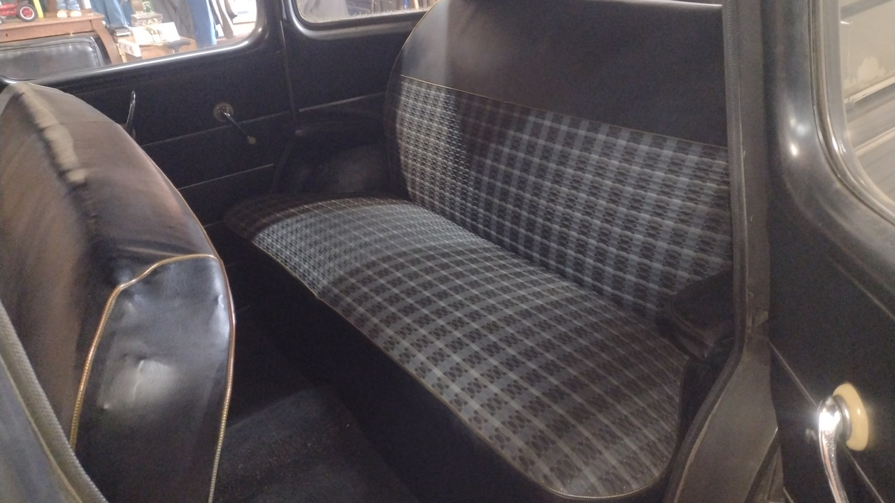

Folks,
Finally got to load John's pictures of his 1946 Ford four door project. Sorry my picture quality is not the best.

Only 3 pictures but it looks like you've really got something to work with there. Looking forward to seeing and reading more about this!

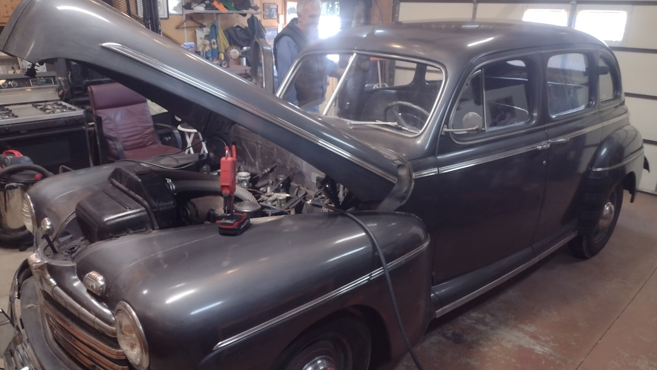

Just had a minute:
Engine bay on the 46:

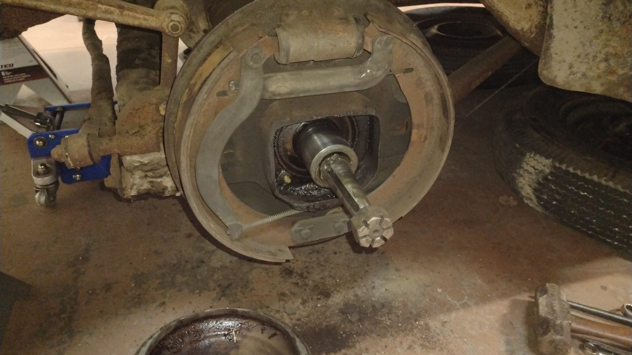

Pulled the rear hubs and drums off. Refresh my memory, please. Long shoe goes to the front along with the larger diameter of the wheel cylinder? Whoever did the brakes put the short shoe to the front on both sides. When I did the 42 brakes, they hedged their bets and did one with the short to the front and the other long.

It sounds right. In my 40 plus career as a mechanic, short shoe goes forward to apply pressure first to transfer the leverage to the long shoe.

if lockheed, long to the front!

Bruce_MO, it's a gun metal gray. I think the car may have been black as that's what the wheels are and they were supposed to be body color. Todays project was removing the front wheels for a brake inspection. Not happy with any of the drums. Need to see if anybody can turn them in the local area or start searching. Rustythumb, that's what I found doing a search for the 1939-48's. 49 up short shoe to the front if I understand correctly.

The long shoe goes on the front, from what I have seen. I just did the brakes on my 39 Deluxe and long was in the front. Makes sense from me from a physics standpoint as the weight will transfer to the front under braking. I don't have my shop manual with me to check.

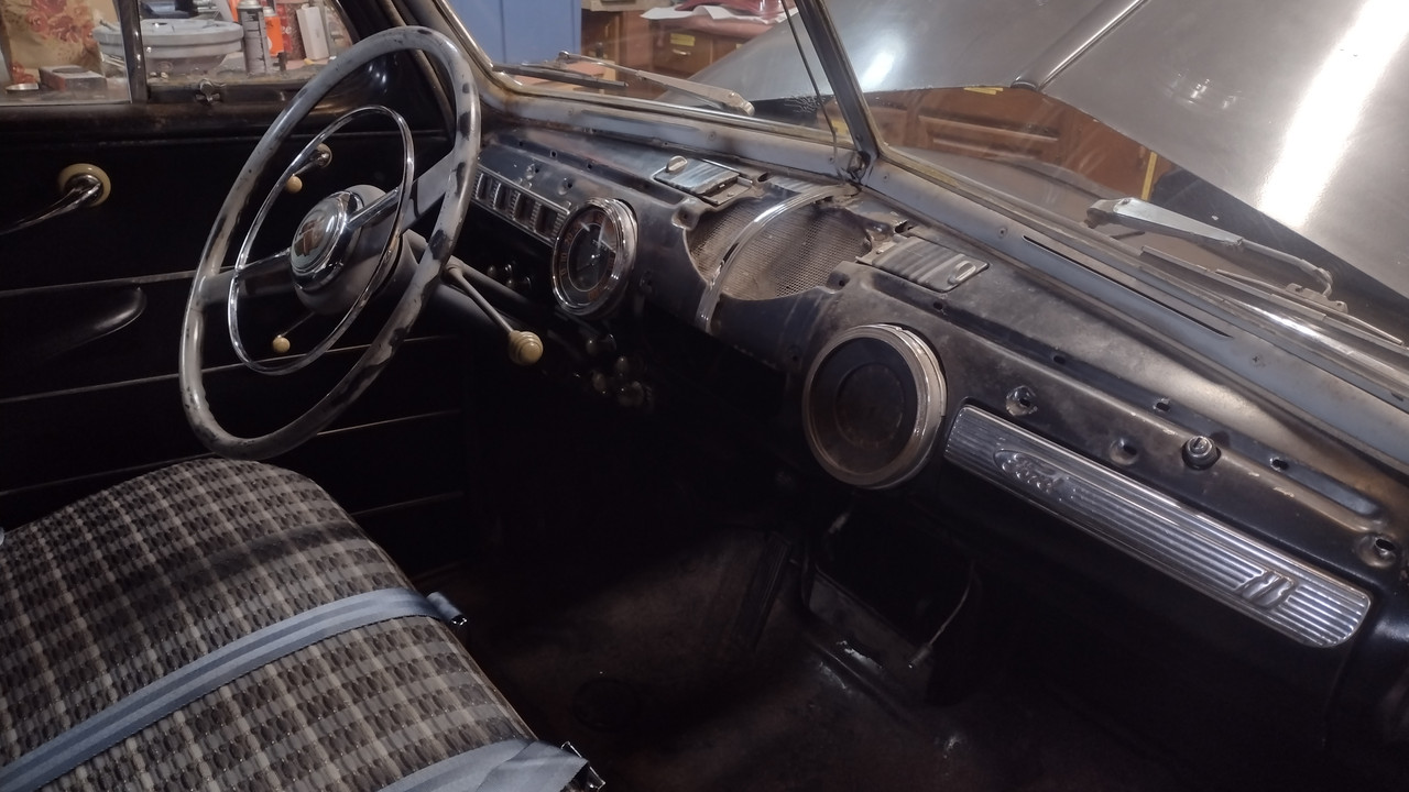

Folks,
Having some difficulty loading pictures, see if these work? Not sure why they seem to be a little large?

John is into the brakes on this 46. All drums off. inspection and pulling retailing rings and inside seals. Drums will be turned, clean up, then new shoes, wheel cylinders and maybe lines. stay tuned as he brings this car back on line.
