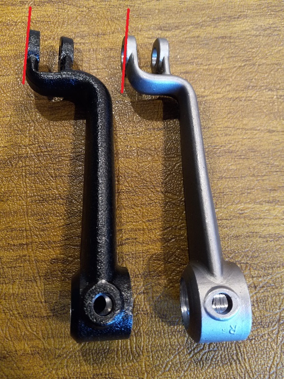

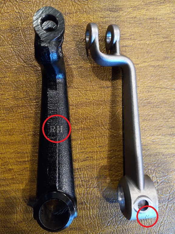

I'm running into this with reproduced parts and wondering if others have found this to be true.......overseas manufacturers don't know their left from their right?
I've got mechanical brakes on my 34 Ford and have no intention to deviate from them. Finding NOS parts are practically out of the question now, so relying on what's in the market is where we have to go. Doing a complete restoration requires replacing many old/worn out parts. One such part are the rear camshaft levers. In order to replace the right camshaft bushing, my only alternative was to destroy the original lever in removal. I purchased a right side lever from a repudiable online seller and have found the lever fits the left side and not the right. The angle of the brake rod clevis attachment is to the outside of the frame, not toward the cross shaft that's centered within the frame.

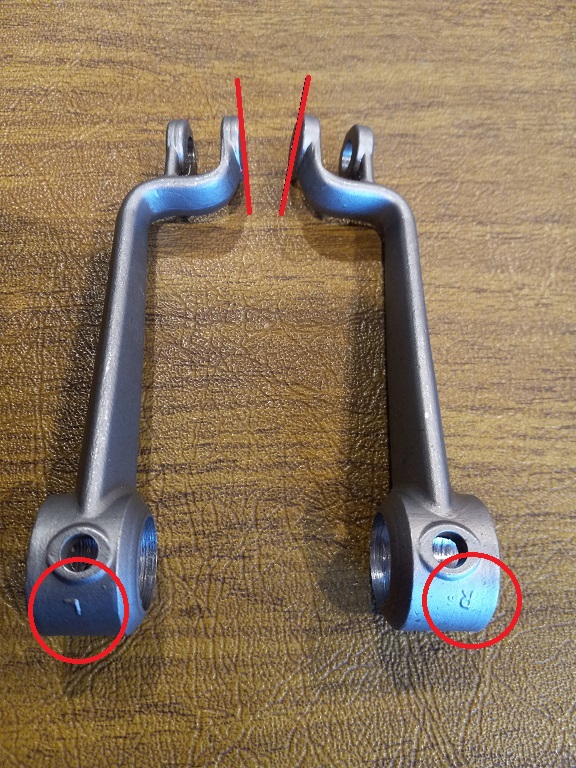

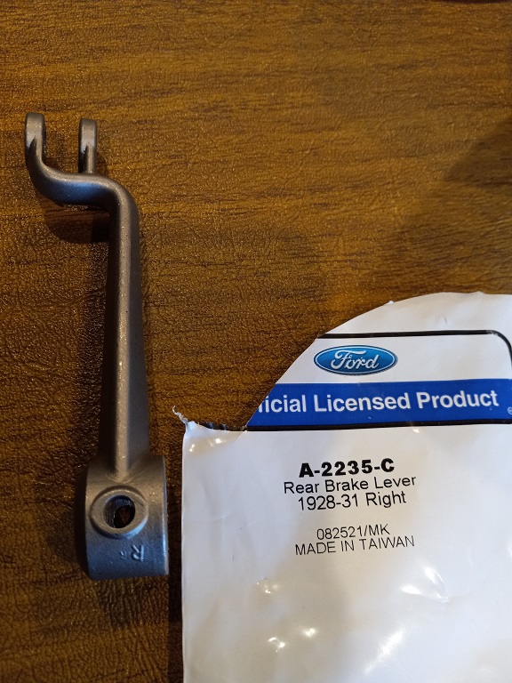

I know Model A camshaft levers will fit a 34, so I purchased a pair from a different repudiable online seller and the images show what I got. They too are marked opposite of what they should be. The clevis ends are bent outward, away from the center of the car when matching the marked right lever to the right side of the car.
These parts are sold as Ford Official Licensed Product, but I think Henry knew his left from his right!!
Notice the label "Made in Taiwan"......enough said!
The fact both Model A and 34 levers have this same problem, AND I ran into this same Left means Right issue with the reproduction king pin set I purchased........the left marked king pin fits the right side of the car. It's buyer beware for not only the user, but for the seller as well.

With respect, what are shown in your photos are not parts original to the rear brakes of a 1934 Ford. The rear arms or levers were B-2235 and B-2236 on '32-'34 passenger car and commercial chassis rear brakes. They only have a slight offset at the clevis end and were pointed downward in their installed positions. The A-2235 and 2236 levers in your photos were originally installed in an upward position. Their 90 degree offset at the clevis end is unique to Model A rear brakes.
Accordingly, the Model A levers shown in your photos are correctly labeled R and L. Whomever advised you that the A levers were usable on '32-'34 rear brakes was mistaken. The manufacturers of the levers in your photos have it right.

I stand corrected regarding the Model A camshaft lever positioning. I didn't realize they are positioned upright on the camshaft rather than downward as the 34. Turning them up, the angle of the clevis is correct.
However, the black painted lever in the first couple of images are the reproduced 33/34 camshaft lever for the right side (as marked by the printed RH on the shaft). It has the same angle as the Model A lever. Unless I'm also mistaken regarding the position of the lever for the 34 (which has the lever turned down), the clevis angle is not correct for the brake rod to travel to the center cross shaft. I'm basing my opinion of the lever pointing down for the 33/34 from what was originally on the car and illustrations of the brake parts of a 33/34.
Again, I'm sorry to mislead those Model A owners who know their cars better than I. But I still have an issue with the mismarked reproduced parts for the 33/34 camshaft levers and their reproduced king pin spindle.

Once again, with respect, your black painted lever in your two photos is not either a B-2235 or B-2236 brake lever. As stated above, those two levers do not have a 90 degree bend in the arm at the clevis end. Whomever sold you (or sells) that arm claiming it to be either B-2235 or B-2236 is badly mistaken. May I suggest a cheap reprint copy of the 1933-34 chassis parts catalog for your library?
In the meantime, check out Vince Falter's website, www.fordgarage.com, for accurate photos of both the Model A and '32-'34 rear brake operating levers.
