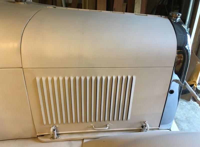

I bought a 28/29 repro radiator shell about 20 years ago and could never get the hood adjusted to get a consistent gap side to side. I believe it had a "Made in Taiwan" sticker on it when purchased. I am in the middle of shimming the body now to improve the alignment and finally pinpointed just what was wrong with this shell. Looking straight on from the side, the hood can be lined up parallel with the shell on the vertical sides, but at the start of the upper corner radius, the step down is angled forward and meets the back of the radiator neck opening tangentially (if viewed looking straight down at the neck). This creates additional gap that tapers from 1/4" at the neck to 0 at the corner. Comparing this to the original shell on the other car, there is a full 1/4" + between the radiator neck and the step down.
My question : Are the repro shells sold now a closer match an original ?
I really don't want to start another rant about foreign made repro parts. Whoever ponies up the money to have a stamping die machined is free to choose where to have parts manufactured, only I do wish they would spend a little more time checking their product before selling it to us unsuspecting restorers.
BTW, I bought a US made repro door for this car, and even after multiple modifications it still has issues.
Kevin

i think i must have the same aftermarket shell as you.
but i have managed to cheat it some to make the gaps a bit better.
the rad cap thing is a bit annoying tho.
my car is not fancy so i just accept it. they are far from perfect, but they are shiny.
i moved the bottom ahead and the top back.
if you can move the rad down that may help. maybe it has shims lifting the rad up?
or maybe the body end of the pivot mount can go up a bit.
other than that your only choice may be to get the original shell replated.
sorry not much help answering your question.

After adding about .280" in shims at the cowl, the hood sides are now parallel with the cowl on both sides, with a bulge over the shell on right side. Radiator needs to shift left to get equal gaps at the cowl but the lower strap is hard up against the frame boss. More shimming is needed to raise the radiator up so it can move left, and the body will need to be shimmed up the same amount.
I measured the shell to cowl distance at the bottom of the hood sides, and this car measures 28 3/8", the other car measures 28 5/8". Is 28 1/2" the ideal distance ?
I have not noticed any bent brackets on the radiator yet, but will compare measurements on both sides.
