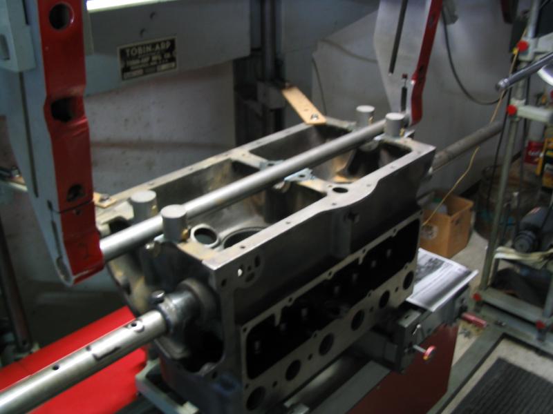

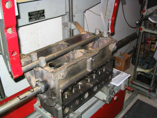

Many a Model A cranks are set off center to the front, and Rear Main, ( Which is most important ) to keep a rear main from leaking, and also time gear mesh in front.
If the crank is off center, as much .010 thousandths, it will cause a leak, you can not fix, with out pouring the Babbitt again, and Align Bore again, this time centering between the Main bolt holes.
On the Model A , Ford used the Left hand rear Main Bolt , on the Drivers side of the car, and gaged ALL their machining Operations off that bolt hole.
The big problem with that, all Align Bore Machines have a Jig, with a set center distance, ( So you get the Gear Mesh Right ) that is used at each end of the block, but while the center distance can be right on, the crank centering, is often not.
An off center crank will leave a gap between the crank, and the Aluminum Seal, and you can't stop oil unless you close the gap.
Even if everything else is right, you have a leaker.
The Factory cranks were always centered, but very few new Babbitt jobs I have seen are.
I have all the jigs sets with my TA-15, A,B,V-8, and Fordson, and none I can use except the V-8, and that I have to use 1 to .005 thousandths of shims, depending on the motor to get the right center distance, but they will center the crank on the V-8"s.

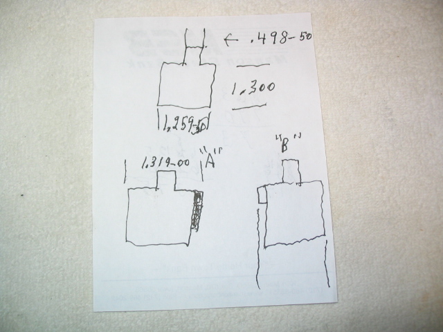

The left hand rear main bolt hole that Herm mentioned was reamed to .505 inch diameter to a depth of 1/2 inch.
From the center of the above hole to the surface of the rear main thrust bearing is specified to be 1.4335/1.4345 inches.
These dimensions are from the Ford drawing of the cylinder block.

Herm, My Kwik Way and Ammco align boring machines pick up off the block main bearing holes, but leave no compensation to acquire the cam centerline to crankshaft centerline distance. I see you like the Tobin Arp set up. Rather than setting up off of false camshaft centerline what would you recommend. The KR Wilson uses a false camshaft bar for the combination machine how do they guarantee proper center to center distance of boring bar frame?

Along with my normal Kwik Way alignment jigs I came up with this set of jigs to make sure the cam to crank is correct. Only have found one block out of many that the Kwik Way jigs were off but no more than a few thou.

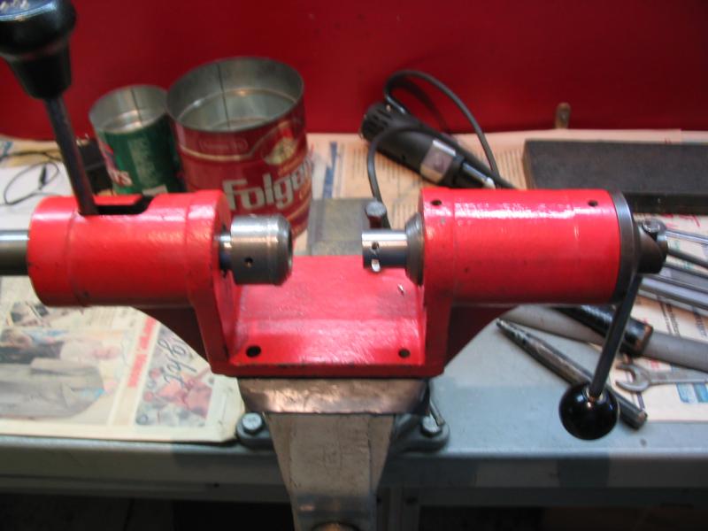

Mr. KR, I used a N.O.S. Kwik-Way for about 5 years when I was a Kid. There are many things I can do on a Tobin-Arp, I couldn't do on a Kwik-Way, but the Kwik-Way is the best Align Bore out there if you are doing only Motors. You also have to make sure that the bar is not wore, and the two center springs, and Collar are set to, I think, been a long time, to 1/2 inch compression, for Bar sag.
OK, John, that is what I was talking about, when a set distance jig is used, you are Limited on getting the crank on the center line, and centered in the block. So if you are off by .010 thousandths, which is very easy, your front seal, rear seal, rear shims, and the transmission Pilot shaft, and Pilot bearing will be off.
So, Guys, what I did, on the Kwik-Way, was to center the Boring Bar first, and lock the bar bearings, so it stayed. I have a used Kwik-Way bar, and two Kwik-Way tapered cones, and run it through the cam holes. Then what ever Center distance you use, take that and add half the diameter of each bar to your center distance, and then Mic around each bar and get a feel so the Mic just passes with very light drag.
So, now, with the bar centered, the only direction for adjustment, is up, and down. Now for that adjustment, you use brass shims to go under your Alignment caps, always equal, on both sides of the two Jigs. I have always had to go up, never down.
Another way to center the bar, is make 4 plugs, two for front, and two for the rear. I will try to find some pictures to show what I am talking about. These plugs just fit the holes in the mains with no binding, or looseness. I made mine for T, A, and B's, all in the same plug.

I just realized on the drawing of the plugs, that I don't have the length of the bolt stub shaft, and the " B " dimensions. But these are for a 1/8th inch bar, and Kwik-Way is 1.250, anyway, but you get the idea.
Herm.

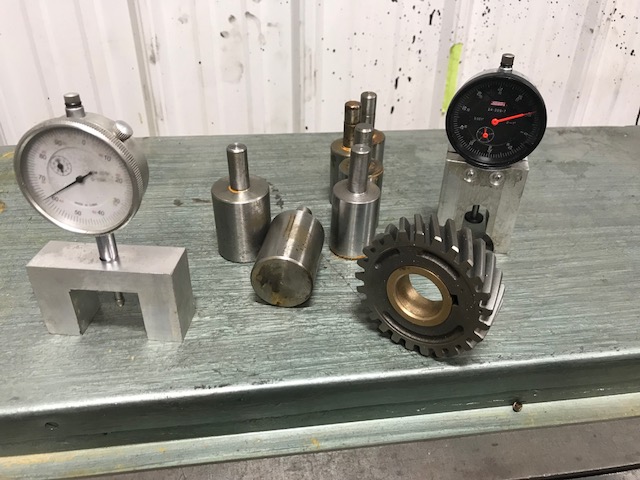

I’m pretty much doing the same as Herm is on my TA-14 except I have converted my machine to use a 1.000” boring bar so I can do Model-Ts too. I locate very similar to Herm’s method with the pins except I have different ones for T's, A's, & B's. Also, I set up a little differently in that I have a modified crank gear for both an A & T that has been bushed down to just slide over my boring bar. I install the camshaft & timing gear I plan to use during the rebuild, and then move the vertical height of the block to be able to set the desired backlash. Next I have a bridge that I made with an indicator mounted into the center that I place over the boring bar at the front main after my lash has been set. I use that bridge with an indicator to measure the set height of the bar, and then use that measurement to set my bar height over the rear main. This ensures the bar is parallel with the block, and as Herm mentioned, the pins locate it side to side.
One other thing I like with the Tobin Arp units (-over the K/W LBM) is their hydraulic drive unit which pushes the bar very smoothly with infinite speed control. Nothing wrong with either set-up, and I know of a gentleman down in Alabama that uses a KR Wilson Boring Plate that he mounts on T blocks and drives the boring bar unit with a T/A drive unit, and it produces some very pretty bearings. I kinda think he may have bored his boring plate from the 15/16" to 1.000" too.

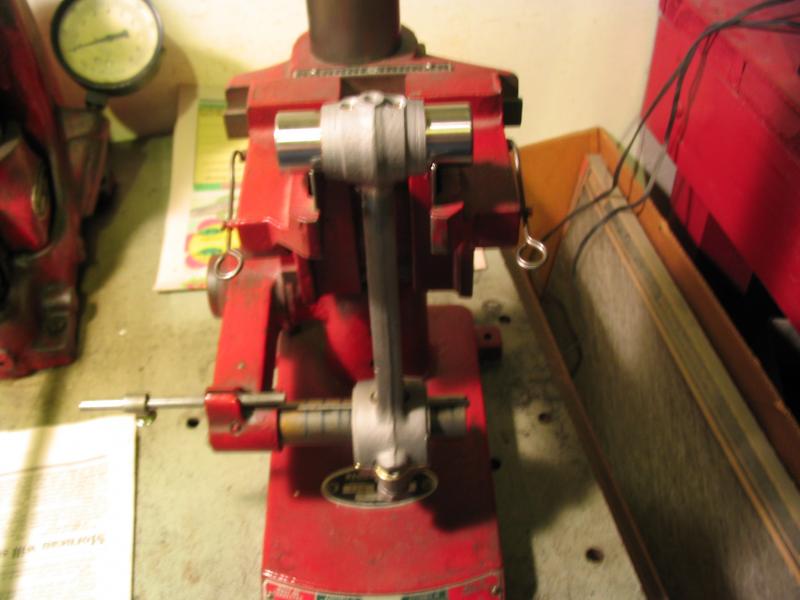

Pictures, I also have the Hydro-Borer for sale, it was Factory rebuilt in about 1950, and never used, long story!
\Herm
