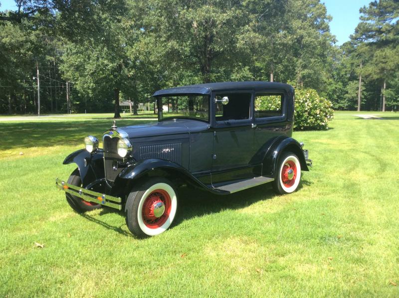

Man they sure are popular. Today's MAFCA 'A' of the Day (8-1-2017) has a group of guys touring out in the NW and all five A's have '35 rims
![]() I don't have a problem with that, it's a bolt-on and no different than all the Mustangs and Chevelles and the like back in '69 that were running Cragar S/S's doesn't take away from the value of the car. Just got me to thinking that there should be a plentiful supply of GOOD '35 Ford rims about. Ford sold a million new cars in '35 it was a stellar year for them even with a Depression still lingering on. Bolt pattern same as Model A and you don't have the weird sizes of say a '32 Ford with 18" tires and rims. I actually prefer the stock look with stock rims and tires myself but I'm mostly stock still have most of my original parts What say you guys?? Comments??http://www.mafca.com/photos/CoverCar.jpg |

Well, before the car was off the carrier I had a set of KH's on the way, just something about the look that it screamed 16's.

I have a set of '35 wheels for my Phaeton and another set for a recently acquired '31 S/W Town Sedan along with the stock wheels.
I plan to mount the '35 wheels on the Phaeton this September when we start an East Coast road trip. I have 16" Coker Classic Radials mounted on the wheels. I keep the 21" stock wheels on the Phaeton the rest of the driving season. I am setting up the '31 S/W as a touring car to tow a camper and will be leaving the '35 wheels on it year round. I have Coker classic radials, 600R-16's on the front and 700R-16 rear. I chose 700R-16 for the rear because the inflated height is the same as new 19" tires. This allows me to use original 19" wheels/tires as the spares for my combined rig. Camper will eventually have 19" and the car can accept the same in any location. The car has a side-mounted spare on driver's side and at the rear. Two spares...better for long trips. I like the stock look but like a little more rubber on the road when touring at highway speeds for safety. JMO Good Day! Last edited by Dave in MN; 08-02-2017 at 11:29 AM. |

I have a set of 17s 5.50 on my '29 CCPU, I feel it rides and handles better with them, than the 21" narrow tires. I don't do shows or fine point so for a driver it works for me. I do like the 21" wheels look.

I have 16's on my Tudor,they were on the car when I purchased it.I like them.

The 6.00 - 16's on the front and 7.00 - 16's on the rear is what I had on my 48 Ford Coupe back in the day. Although my rears were 7.00 + don't remember exactly what. Gives it that "raked" look. Show us some pictures. David Serrano |

I had them on my 29 special coupe but they just didn't look right and were difficult to mount over the studs because you could'nt see them inside the hub, I found them tough to clean also because of less space between the hub and the rim. I had 17s ( 33/34 ) on my 30 roadster and they rode good and were easier to clean than the 35s.

I simply prefer the 19's on my rig. And now that Radial tires are available, I like them even more. A lot of guys here went to 16's, just because they could get radial tires at Costco. I held out for the Coker 19" radials and couldn't be more pleased with the performance and ride.

Well, there's a LOT more to it than just the idea of popularity. Admittedly , the '35 wires do look good, particularly the 40 Kelsey bent spokes. However, they have much more rubber where it meets the road and that makes for better braking. Besides safety, the tires are much more available and in steel belted configurations, if wanted for added safety..your choice, and choice is good
