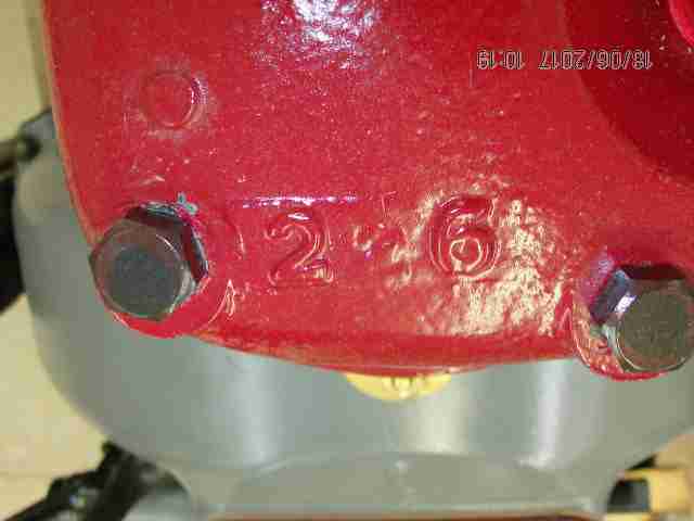

Originally Posted by Royce P View Post
Actually the casting number on early Model T heads are the day of month (1-31) and the month (1-12). There is not any indication of the year.
Hi Royce -
Is this one Feb 6th or Jun 2nd? The block was cast Aug 13.

Jesse its June 2.
Originally Posted by jesselashcraft View Post
Hi Royce -
