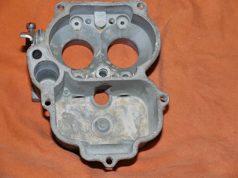

I have an off idle stumble on my 52 F3 239. Starts right up cold or hot and idles fine. Almost seems like the accelerator pump squirt is delayed. It works, just seems late.
I put a kit in it when I first got the truck just to get it going. Today I pulled the carb off and took a closer look. Got a lot of white crud in the bottom of the fuel bowl for only about a year of running. Ethanol fuel? Entire fuel system was cleaned when I did the carb.

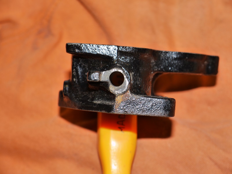

There is a lot of play on the linkage side of the throttle shaft. For some reason the throttle plates were riveted on with tubular brass rivets. The shaft needs to be replaced. Where can I find one like this? Not the extra long type for multi carb setups. I have the hand throttle to hook back up.
I'm going to have to chuck the base in the lathe or drill press and make a bushing for this wore out hole. The boss sticking out in the pic will chuck up pretty tight.

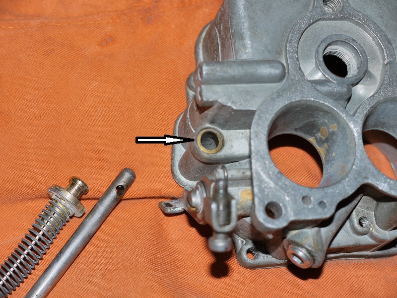

The second last pic shows a worn out bushing for the accelerator pump rod. I'm wondering if this is the cause of my pump delay? Thinking it may move laterally before pushing up and stroking the pump. Any thoughts on this?

Sloppy bushings shouldn't cause a stumble, unless the shaft hangs up. More likely, the accelerator pump piston is of a poor quality, or even the shaft is wrong, as kits do come with multiple parts for different carbs. You'll be much better off with a soft leather piston soaked in oil. The kits these days usually come with a funky blue material that doesn't hold up to Ethanol.
Another likely cause of the stumble would be the size of the main jets. You need .051 jets for a single carburetor. Smaller jets are used with multi carb setups.
Other than those two causes, there can be obstructed passages, missing or stuck accelerator valve ball, ineffective power valve (AKA Economizer valve), vacuum leaks, or any number of combined ailments.

Thanks for the reply Allan. The power valve is not blown but, I'll check to make sure it is the correct one. The ball is there, the body was soaked in Berryman's Chem Dip. The accelerator squirts very well, just seems late.
I'll check the main jet size. The kit did come with the blue pump and a black one. The leather one will hold up to Ethanol?
You gave me some good info. Thanks!
Scott

There is no bushing just a felt sealing around the accelerator pumprod.

Charlie NY may have a shaft. It not the catalog people will. You can cut your own end on a replacement shaft for hand throttle if you have to. Not hard to do.

I think my problem was the accelerator pump. The blue one was dragging really bad. The black one is snug yet moves more freely.
The worn shaft is just something I noticed after tearing into it more.
The accelerator pump rod does have a bushing on my carb. See pic with arrow. Not sure if original or not. I tried all the adjustment holes and the center was best but, I still had a stumble. Just off idle.

Charlie NY doesn't recommend bushing the base based on his experience. I don't have another base so I may have to try. I posted up I am looking for another carb or base on the FTE forum. I'll ask here too.
