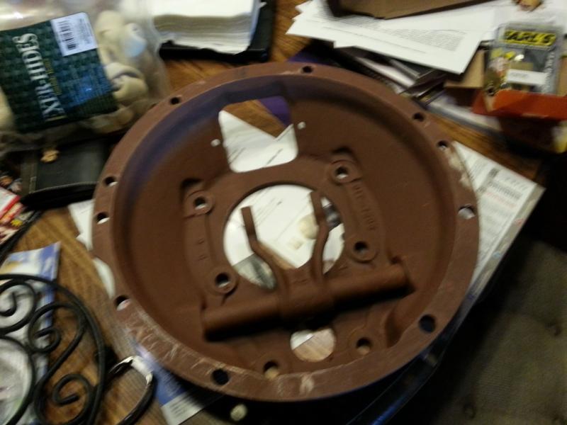

A Hogshead is the adapter that Ford used on the later 1940s trucks between the block and the 4-speed. To use a Hogshead on a 1949 and later engine you also need an adapter between the block and the Hogshead like the one shown in the last attachment.

Using a Hogshead to adapt a T5 is a different approach that uses a flat plate adapter as opposed to the bellhousing style of adapters. (last figure of hogshead is from VanPelt).

That is true, only the 2 3/4 inch will work as a T5 (or other later) transmission adapter. The measurement is on the attached figure in #3 above. The thicker one is Much thicker.
