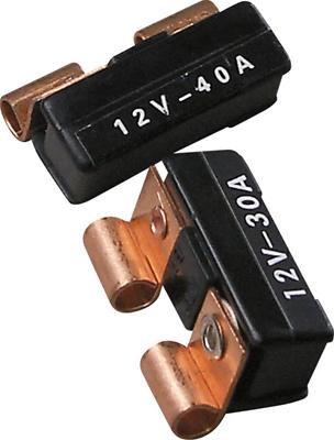

bogiediver brings up a good point- the thermal response characteristics. The cheap automotive glass-fuse replacement breakers are not ambient thermally compensated and will trip at a significantly lower point when hot. In addition, all bi-metallic snap breakers get 'tired'. When new they work at the rated amperage. After several trips the trip point permanently lowers. A 30A breaker tripped 20 times becomes a 20-25A breaker. The only fix is to replace the breaker. In all cases, a breaker responds more like a slo-blow or time delay fuse, not like a fast-acting simple element fuseable link.
This picture is a Type II.
Types for low voltage auto breakers go like this-
(From Littlefuse)
Type I – Automatic Reset
Cycles or continuously resets until the fault is corrected. Type I circuit breakers
are typically used to protect circuits which occasionally experience momentary
overloads such as wiper motor and headlamp circuits where a self resetting
device is preferred.
Type II – Modified Reset
Non-cycling, remains in open position while there is power to the circuit. Resets
when ignition is turned off. Type II circuit breakers are typically used in applications where fuse replacement is objectionable, such as power window, seat
and sunroof circuits.
Type III – Manual Reset
Manually resettable circuit breakers remain in the open position until a button,
lever or other external reset device is manually depressed. Type III circuit
breakers are typically used in applications where a manual reset is desired for
safe diagnosis of a circuit fault.

Been running a CB for years as do a lot of club members with zero problems. They look like the ones in Mike K's picture only they are 30 amp. My son is selling them for $10.00 to help with his restoration.
I'm glad the circuit breakers haven't caused anyone in your group any trouble yet. However, it's a good tidbit of info to keep in mind when they finally do have troubles with them.
