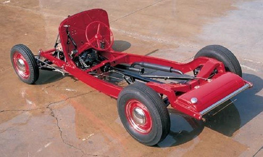

The shocks are mounted inboard because the frame was Z-d, eliminating the stock mounting location
The rear end is an early 32, as noted by the round torque tube flange as well as the dog legged radius rods.

I've never seen Houdaille shocks bolted up like this. I guess there wasn't room between the frame and the tires. Seems a shame to bolt a body over it all and hide all that nice work.

The late 32 through 34 rears are a great candidate for your car - given the curved rear-spring that fits the stock rear cross-member. Also, the rear will be located (front-to-back) where it should be.
Original Lever Shocks: I'm not a fan of original 32 shocks - have had two sets rebuilt and they did not last long, nor did they actually do much for the ride. The Rotoshim stuff is really nice - though VERY pricey.
Tube Shocks: They are obviously far cheaper and easier to get than any sort of lever shock - and 'yes' they are period correct for what you're doing.
a) Do not try to mount them behind the axle with a 32-34 spring setup . . . there is NOT enough room for them to fit and be at the correct angles for best performance.
b) The cast shock adapters that folks sell that pickup two rear backing plate bolts are designed for later rears - the "clocking" of the backing plates is different in 32 - 34, so these "bolt on" lower shock hangers will not work. I know this because I bought 2 sets of them . . . they're in the box. Also, as noted above, there is no room for the tube shocks behind the axle.
c) When I helped a friend with his period correct 32 roadster, I decided to go a completely different route. I made lower shock hangers that bolted to the same bolts that the radius rods bolted to and then make a tubular cross-member that bolted to the frame and was used for the upper mounts. His rear end was an early 32, so the radius rod mounts were straight - though I will make a similar setup for my 32 Cabriolet that has the later 32 rear with the angled mounts.
Here is a pic - this should give you an idea:

Hey Hank - not sure you're talking to me, but the rear in my picture is an early 32 with the straight radius rod mounts.
I will make similar lower mounts for the late 32 rear in my Cabriolet (the radius rods are straight and the bracket on the housing is angled).
The nice thing about this setup is that it fits really well, you can set the shock angle to be what is optimal for the shock, and it actually looks better from the rear. The tubular cross member is totally easy to make and in the case of the car shown, I made it a bolt-in setup.
Here is a link to my Instagram account - where you'll see a video of the setup. Note: The frame is up on my lift, so the rear end is hanging much lower than when it is at ride height.
