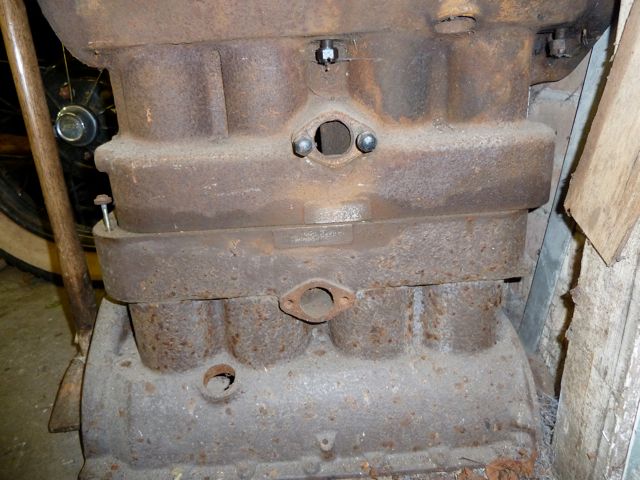

the post 'england engine build numbers' show interresting pictures, the aAFand A block are not the same, so I think it's not possible to bore a AF block to a A block.

I have 1 of those AF and just measured with a caliper thru the water inlet and cylinder 2&3 there is not enough to bore to A engine spec

Consensus around this English breakfast table is no it can't be done. 14.9 and 24hp blocks completely different. See gaps between cylinders in the castings as shown in the photos.
Rod can you post pics of your AF block? Does it have those same gaps?
