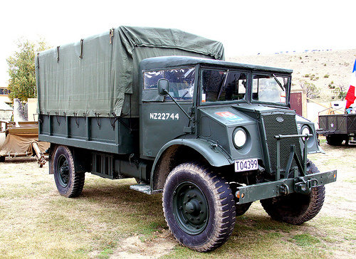

My mate has just bough a WW2 ford blitz, good buy with a rebuilt flathead,
Its a 4x4 with hi and low range,
But it is geared as low as, and at 40 mph in high range the eng is revving like an F11,
Is there ring and pinions avail to get a bit better speed with less rpm.

My avatar is a '42 F30S [CMP Canadian Military Production]and I recommend you live with the gears. Front and rear diffs are matched. Probably the 'banjo' type. Change the rear and have to remove the front drive shaft. Newc

Believe them to be split Timkens. An option, though I don’t know if they would fit, would be 5.14:1 out of an F4. I think they would, but a Ford truck manual would be a good source. Check with Chuck Mantiglia of Chucks Trucks. He has most likely forgotten more truck stuff then most folks ever knew. He deals with MH restorations, as well as cars, pickups, and trucks.

I agree with 1952henry, if the axle looks like the one in the picture the best you can do with gears is 5.14 1940-47 ford 1.5 ton.
