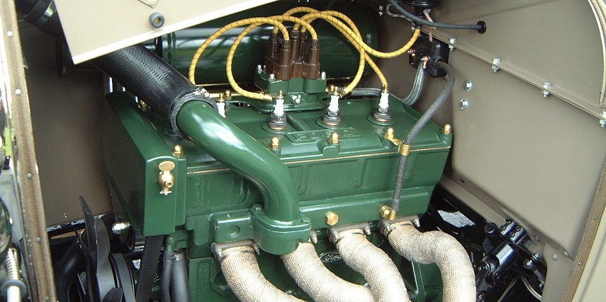

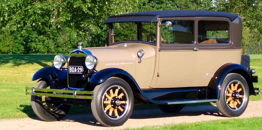

If you really want to "soup up" your Model A, check out this video........these guys in Finland have figured it out for their basic 1929 Tudor ......250hp and 0-60 in 5 seconds and top speed of 124 mph! (crank up the volume on your speakers to get the full effect):
https://player.vimeo.com/video/97916836
At the end of the video they share some of the mods they made. There are also 200 photo of their build on their website: https://www.mat.fi/projects/68
Brad in Maryland
