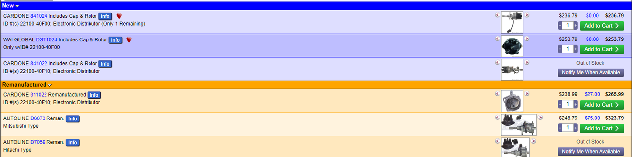

I see that Nissan is a light pickup. At https://www.rockauto.com/en/catalog/...stributor,7108
it shows Mitsubishi and Hitachi types, which one is preferable? (I see one is out of stock)

I don't see a vacuum control canister on any of those Nissan distributors.
If you want points ignition you are going to have to go earlier than 1980. Prices for the Honda Civic distributors used to be in the $25 to $100. range.
Perhaps Tanglfoot or Synchro 909 can post a picture of their setup.
