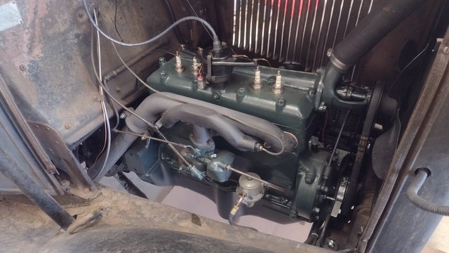

Still learning here. Took another run at the timing of the 1932 vintage "B" engine. Re-read the instructions using the test light. Realized I was trying to turn the light on and off , opening and closing the points, with the cam lobe screw tight. Loosened that and the rest worked well! Took the dump for a 5 mile run and it preformed as well as a 90 year old Ford should.

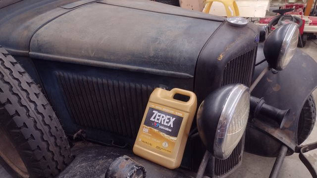

Well John was near NAPA when he called me this morning. I had just taken a picture of Zerex antifreeze and remembered that NAPA might have some. John brought me a gallon. Drained the water and added the (non foaming Valvoline).
Started the engine and other than the starter switch sticking on the initial test, all went fine. If the weather breaks I will get it out on the road for a test run.
