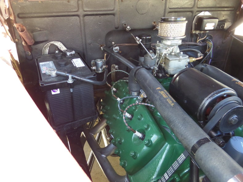

Originally Posted by Terry,OH View Post
Battery is grounded to the firewall and there is a second ground on the firewall to the engine head stud.
OK. Just went through lots of flathead engine compartment pictures on eBay and did what I should have done first, looked it up in the EFV8 club 41-48 Ford book.
Of course you are right.
"Three threaded studs for ground strap are swaged into the firewall. As the battery on a 6-cylinder car is on the driver's side, while the V-8 battery is on the passenger side, two studs are provided, one of which will be unused on any particular car. A third ground stud is located near the lower center of the firewall for a ground strap that will connect to the engine via a convenient head or manifold bolt."
Located both the 6-cylinder and engine ground studs. Never noticed them before. No engine ground strap. One more thing not done right by the previous owner(s). Before I even get my hands dirty messing with the starter bolts, I'll buy and install that firewall to head/manifold strap.
Not my car, but here's a picture from something on eBay. I see the engine ground strap just to the right of the starter solenoid. Looks like it's connected at a head bolt but a little blurry.

Sorry, not clear. I was looking up 1941 Fords for sale hoping that one of them would have an engine compartment picture showing the engine ground strap.

Problem solved.
Engine ground strap arrived in the mail and I installed it today from the firewall to the intake. This part was missing when I bought the car a year ago. Hot cranking is now just as good as cold cranking. Just as good as a 12v conversion for my purposes.
Thanks to FordBarn for helping me identify the missing part.
