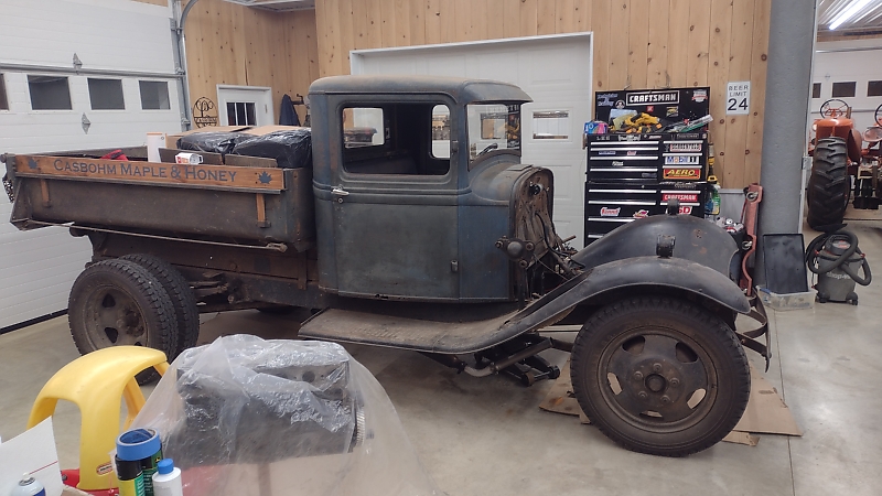

Ford Folks,
The truck waits for a new engine:
I will remove the pan and start to do an evaluation on that pesky oil leak.
I believe there are three potential areras as mentioned.
- The back and forward movement or clearance in the crank The thrust clearance in the rear main could be way to much.
- The passage through the rear main to deliver oil back to the pan could be plugged.
- the gasket from the pan to the rear main could be out of position causing leaks.
I am going to put my money on the thrust being way to big! This engine was well worn when I recieved it and I did not attempt to check the thrust. The other two areas were generally adressed as I put the engine back together.
Several folks have asked what will happen to this engine? I dont know. Not going to throw it away for sure. The water leak has not been located so that is the biggest problem with the block.
Every one needs one of these small jib cranes! Great addition after using a cherry picker for years!

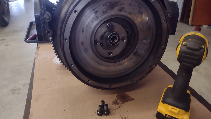

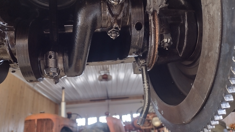

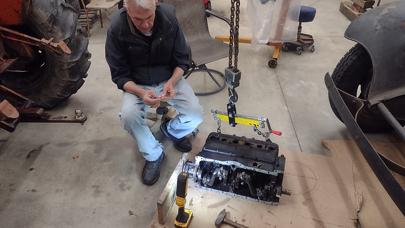

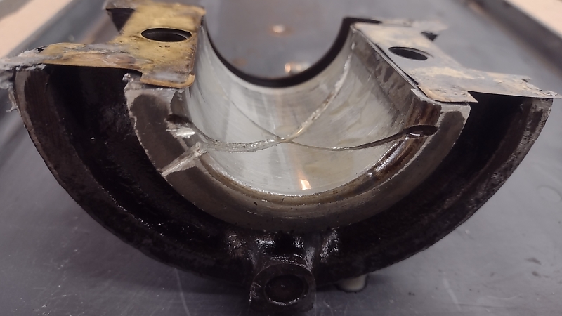

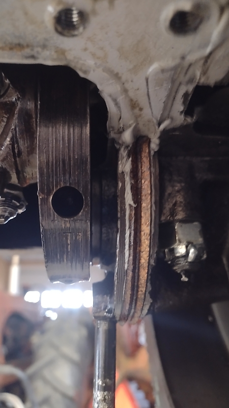

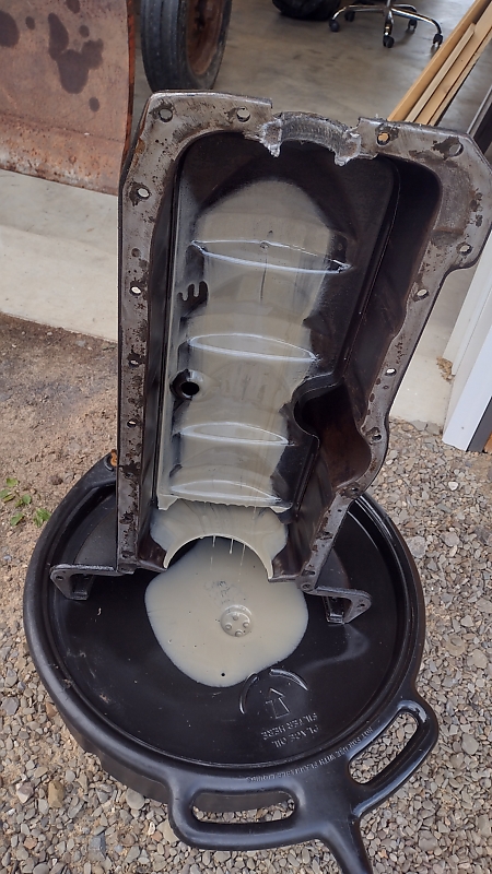

John came over to play in the shop with me last night. We did some checking on the B engine as it came apart. As I dropped the oil pan I got a look at the rear cork seal contact area of the rear main with the pan. This looked as it should with full contact between them. That takes that leak path off the list.

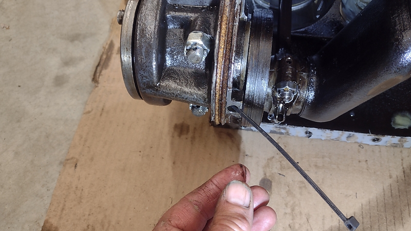

Next was the passage way from the back of the rear main down to the oil pan. Took off the homemade tube and it was fine. Used a plactic zip tie tp probe the rear main and it was open and clean too. Another item off the list of potential oil leak problems.

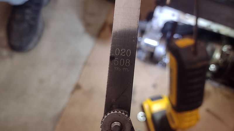

That left the thrust as the culprit, or the end play in the crank at the rear main to crank.

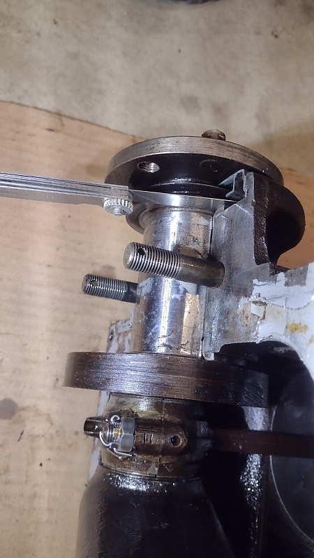

We removed the rear main bearing cap. Bumped the crank fore and aft with a block of wood and 2 lb hammer.
The clearance we found was .020 inches of clearance between the thrust Babbit and the crank. I believe that this should be around .004 inch. In hind site I may not have done anything with that area anyway. As this was intended to be a quick transplant to get the truck moving. It for sure did all that and more. Just threw a lot of oil out the back!
Some pictures coming.
Water leak in the block caused the undesiriable milky oil mix! That may be the down fall of this ever being a usable block?
The numbers matching intermediate bell housing will be swapped back to the MW block.
Along with the timing cover for the 32 engine support, and the cast pulley.
John looking over the damage!
Crank bumped to the rear of engine. I believe this is where the large gap (.020 inch) would allow too much oil to exit the back of the crank to the slinger. Too much for the oil galley to drain quickly some was ejected and caused a problem. I am sure in the day this may not have been a problem, just add more oil!

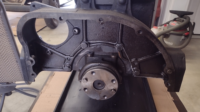

So this thrust are can be fixed as the machine shop did with the MW engine. But with the crack in the block water jacket that would have to be resolved first! Its somewhere between a running engine and a boat anchor at the moment!
The engine parts needed for the Monkey Ward (MW) engine will be removed, cleaned up, and the process will begin again.

It is possible to reduce end float by building up the babbitt. I just did it on one of my engines. But I don't know how it would be done on a babbitted motor rather than an insert bearing motor like mine.
I can see how Ford improved the rear main design on the V8 by bringing it all inboard. Like you say, the oil has a long way to travel to be able to drain back to the pan. I'm glad I'm not a 4 banger guy.

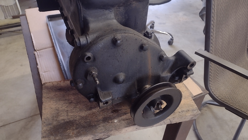

I did not acomplish much today as a cold has its grip on me. Spent the afternoon in the shop tinkering with the old B engine. I pulled the head. It was not very pretty.

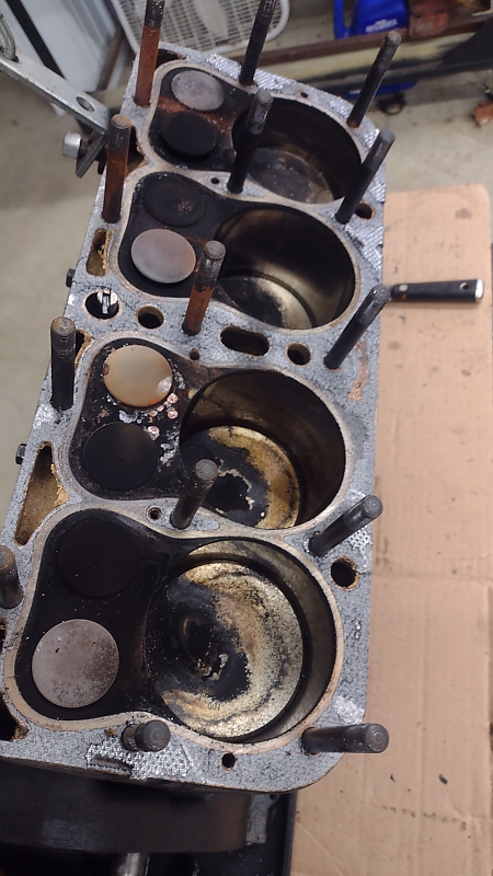

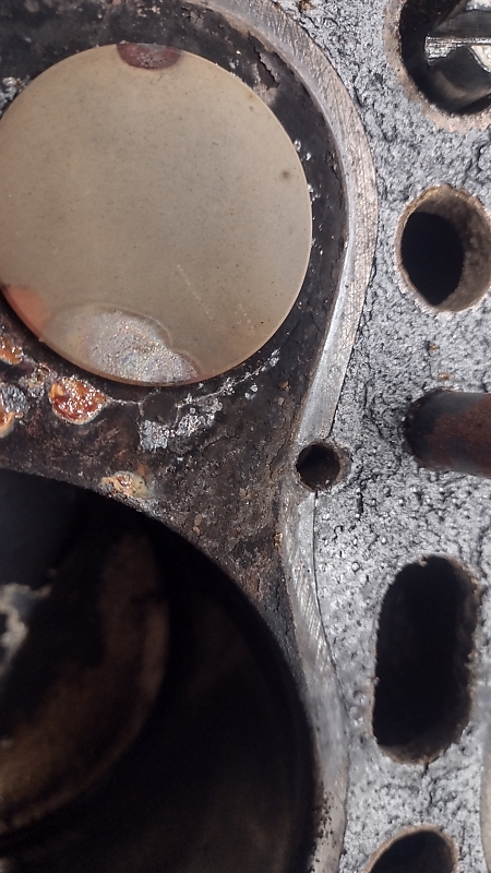

Number 2 cylinder had surface rust on a portion of the cylinder wall.

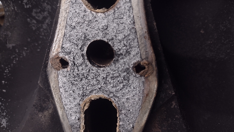

I found a suspect spot on the head gasket right at the place where a small water hole is on the edge of the gasket.This was at the back of #2 cylinder Could this have been my water leak?? I cant remember if I ever retorquing the head nuts?? Why are the gaskets this close to the water holes??

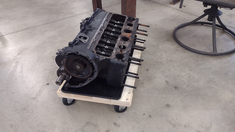

Pulled off other items and cleaned up the block to set it aside. I could have additional testing done on this block to maybe 5-10 psi to try to find other leaks??
Harbor freight rolling cart makes a nice resting place for a B block.
