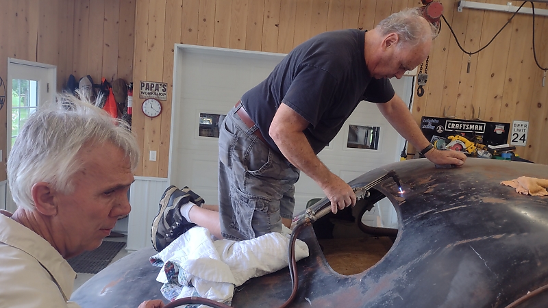

RKS.PA, Funny you mentioned the oil in the fan. Yesterday after spending most of a day pounding out the dent in the roof (I had help, thank God!) I started the car and had a chirp from the front of the car. I was thinking one of the China waterpumps had a problem. Took the generator belt off and the noise was still there. Removed fan belt and the noise went away. Took fan apart and cleaned everything. There was some oil but I'm guessing not enough. Also felt the fan belt was too tight and generator/waterpumps belt was too loose. Corrected that. Started back up and we're back to quiet. Probably a little heavy on oil level in fan. Anybody have any real world experience with Drake's sealed bearing unit?

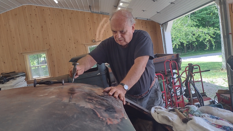

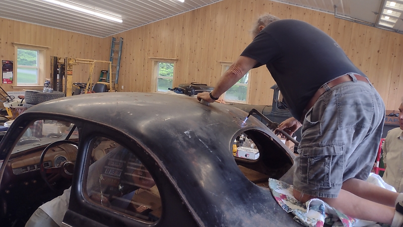

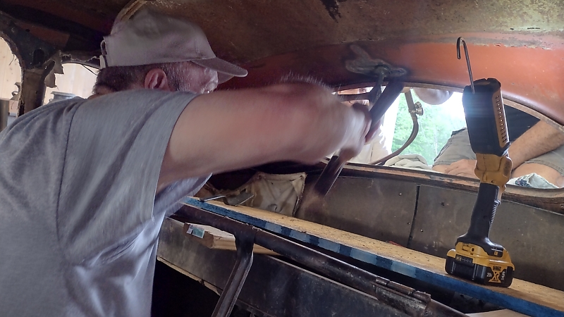

Folks,
Some pictures as John and his crew work to remove the large roof dent causes by Big Bob's Butt years ago! These pictures are graphic. No small childern or pets were injured during the process!
John getting in on the action with some fine dolly work on the inside of the roof panel of his 42 Ford!
John S heads up the dent removal team.
Jim B works some hammer magic over the 42's package tray:
The ends results were that a very thin layer of filler should allow this area to return to its prior bueaty! This is what happens when old guys get together. We had a good breakfast with two other friends and solved most of the worlds problems.
