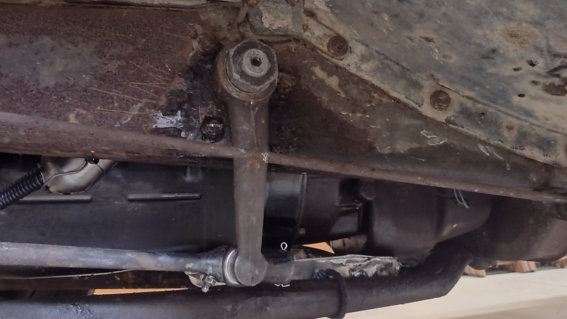

Today we changed our the old 'casbohm' welded pitman arm with the new one. Went well, drives good!

New pitman arm in place on the 32. Time to get it loaded up for a road trip.
Oh good shot of my drip try also. That should go away this summer/ fall if I get busy with the rebuid on the engine #1.

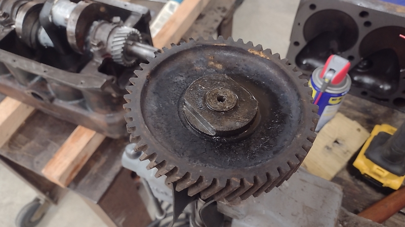

I have begun the assembly of the engine #2. Had a heck of a time getting the cam gear nut off. Finally googled it and found good info on the barn. Put the cam and gear in the block and used a rag to go in the gears. Made a very crude tool to fit the round nut with the two flats. The old fiber gear will be replaced with a aluminium one. May use the old nut??
Have the crank in place with the new rear seal. Not torqued down. May have to take out to put the timing cover and seal in place for the front of the crank forgot about that upper front seal. The timing cover I need is on the other engine in the truck. Humm!
Anyway a little progress.

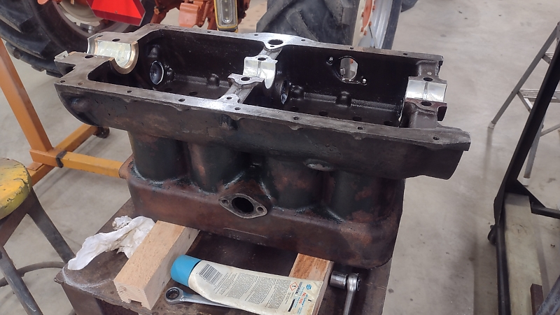

Ford Barn Folks,

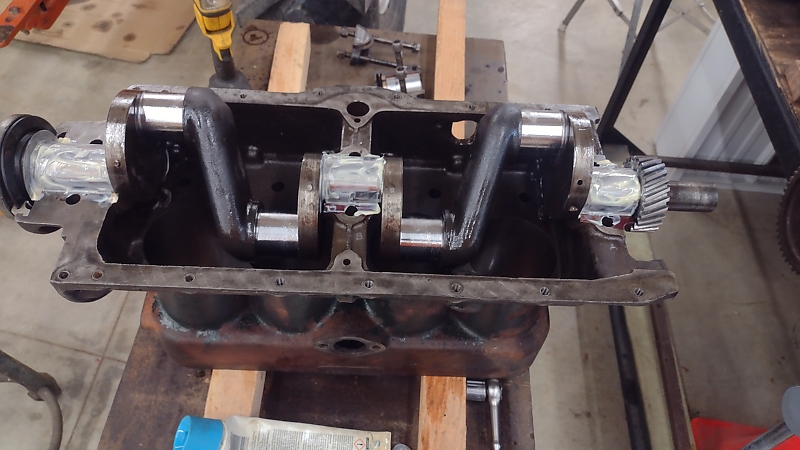

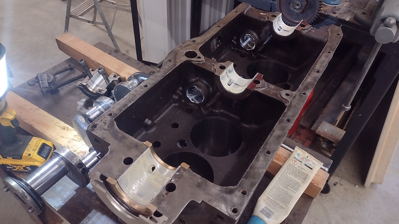

Some pictures of the B engine #1 during initial stages of assembly work. I think I may look at fabricating a side engine stand for the engine. Sure would be a lot easier to manage it.

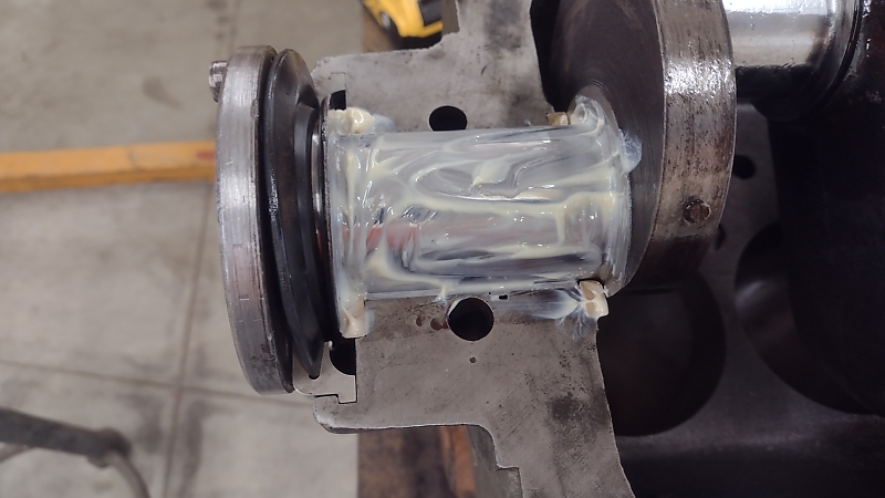

Lots going on in this picture, new thrust washers in place, new replaceable bearing insert in place, new rear aluminum upper insert custom hand fit and installed in block.

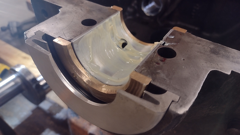

New style rubber rear seal on machined crank:
Adjustable lifters in place. Block was machined to allow lifters to be adjusted with out rolling the engine over as much:
The new oil drain tube, off lower rear main, in place and drain checked to make sure it is open:
Rear main in place over the rubber rear seal, and new thrust washers fit into the block:

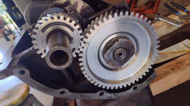

The old cam gear didnt make it (damaged) as nut was removed. Have new aluminum cam gear to install:
Hope things are good in Ford Land!

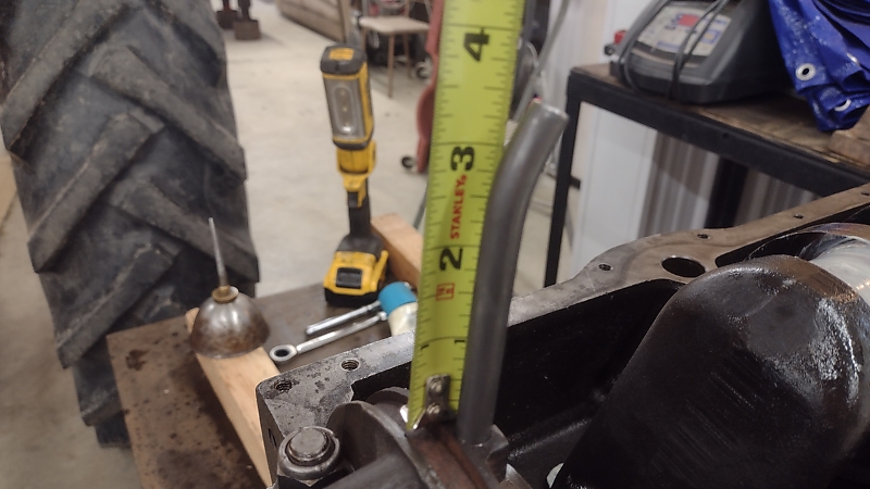

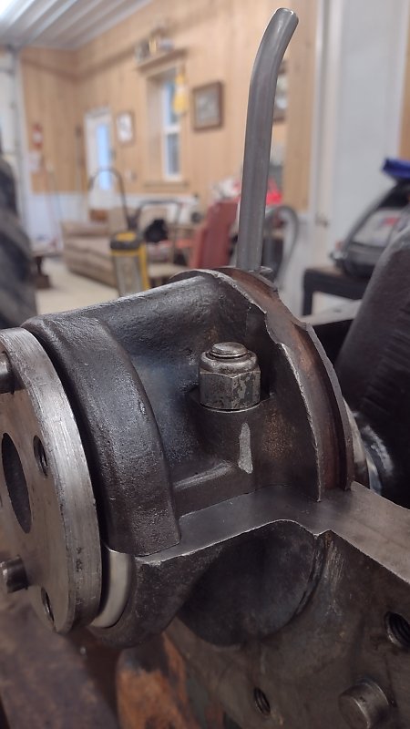

Make that oil drain tube is not screwed in too far. It will block oil passage and result with big oil leak.

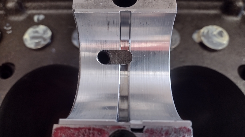

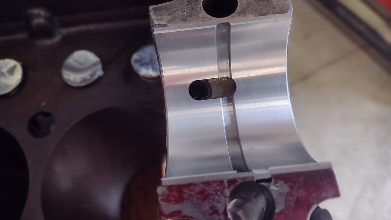

Hey Chris - was wondering why the bearing shells are covering up part of the oil feed hole? Can't tell on the middle and front? (can't see them). Normally, when I'm building any type of engine, I make sure I modify the oil holes for full-flow. I would normally take a die-grinder and open up the hole in the block (elongate it to pickup the feed of the bearing).
I've not built a 'B' engine, so this may NOT be a good idea on it . . . but I do it on every other type of engine I've built.
Any comments from others who build B's and have upgraded to insert bearing shells? Is this "normal" and is there a specific reason for it? (Like reduction in oil flow???).

Dale,

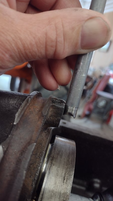

I will double check this. Yes they need to be open and the machine shop and I checked them too. But won't hurt to double check.
Brian,
The oil tube has a slot cut in it to allow oil to pass into that down tube drain. That slot is on the side away from the bend and should align with the hole in the rear cap. I will look at that again too.
Appreciate the eyes on the B engine assembly.

Ford Folks,
The oil return tube, it has the slot, to be located to allow oil to enter the tube.
Showing depth if screwed all the way in.
The oil passages look to be ok and should allow ample oil supply:
Rear bearing unsert upper:
Center bearing insert upper
Front bearing insert upper
I did get the new alumimum cam shaft gear installed, same old nut. I figured the next guy can wrestle it off in another 90 years! Seems like the pin depression should be a little deeper??
Regards,

Chris,
I agree. When they are that shallow it is easy to miss the sweet spot with the timing pin.

Hey Chris, the oil passage alignments look good - maybe in the prior picture the shell wasn't "centered" side to side. Good that you checked it out - never hurts to double check anything related to the lower-end and oiling!

Hey Chris: I don't know a thing about B motors, but it looks to have a big rubber "slinger seal" on the back? Am I seeing that correctly? What can you tell me about it?

Dale,
The slinger was machined off the crank. A area on the crank is where the rubber seal rides. Yes a large rubber seal. Hope the seal works!
