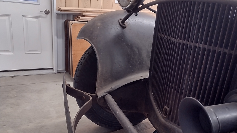

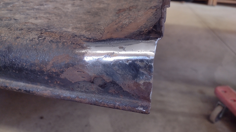

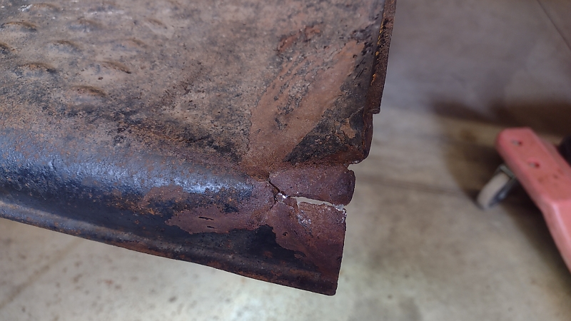

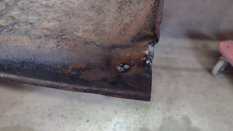

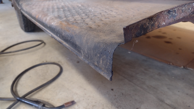

Repairs to the damaged running board:
This rip at the back of the running board is one of many things that could be repaired on the truck. Metal was crinkled and bent from damage. Hammer and dolly work to get it back close to original:
Get the Mig and add some metal:
Gently grind but no need to get it perfect, just would not look right if it was too good.
I used some of GBs ideas on the patina. Flat black paint from about a foot and a half away. Light coats. Then several versions of dirt, grindings, and dust rubbed into the semi wet paint, followed by several more shots of primer. Not too bad! Thanks GB!

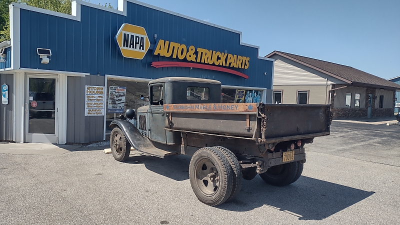

I took the 32 to NAPA today to get the air filter for the 2015 truck. Got some attention along the way too!
Really enjoying getting it out for nothing special, just hauling myself into town as Billy Joe Shaver sang about!

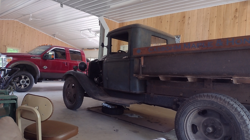

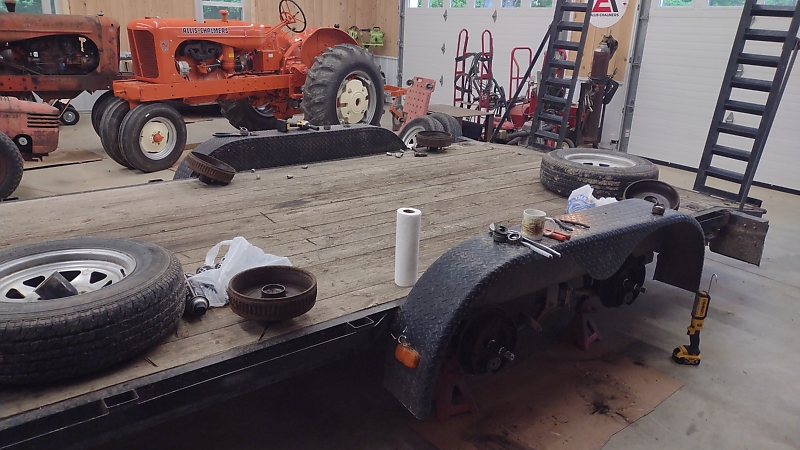

Getting the old gooseneck serviced:
The trip into town for supplies:
Just resting in the shop "living room"
Our picture window view from the couch
All the soft details are in place to attend the Early V8 club National Spring meet in Franklin.
Of course it was alast minute thing. Just the way I do stuff! Just need to get there and back with these ragged ol Ford trucks!

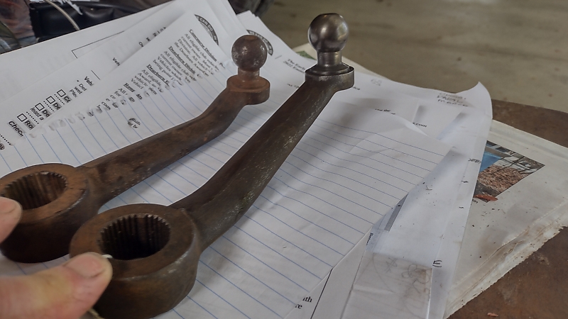

New 32 Ford truck Pitman Arm. Nice to be able to find the correct NOS parts!
The one on the left is for a 33-34. The right one (correct) has more bend and a slight kink to align the ball with the straight drag link. Should work just fine.

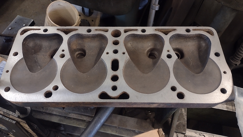

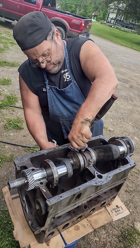

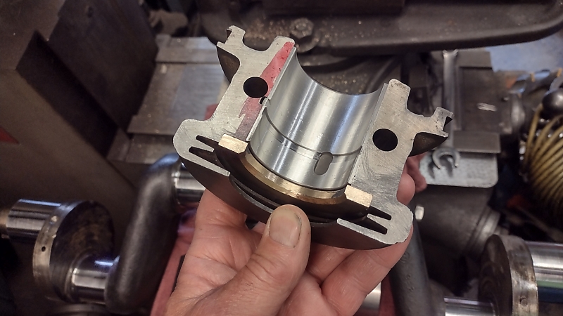

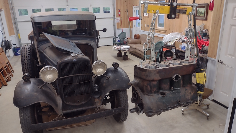

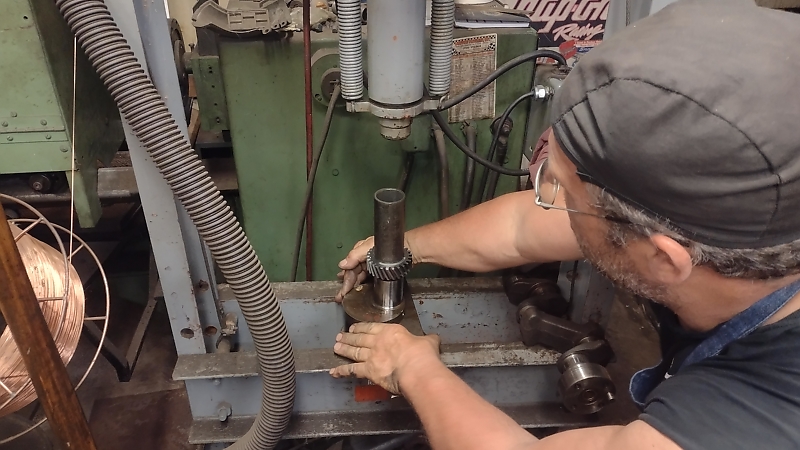

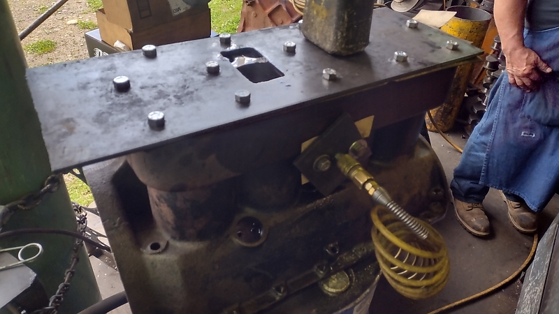

Spent half the day at the machine shop learning about the reworked "B" block, Known as engine number 1. This is the engine that was a reman block sent to Greenvile PA Montgomery Wards.
Tim Waid is in the pictures cleaning and doing some assembly work to teach me about the rear seal.
Head

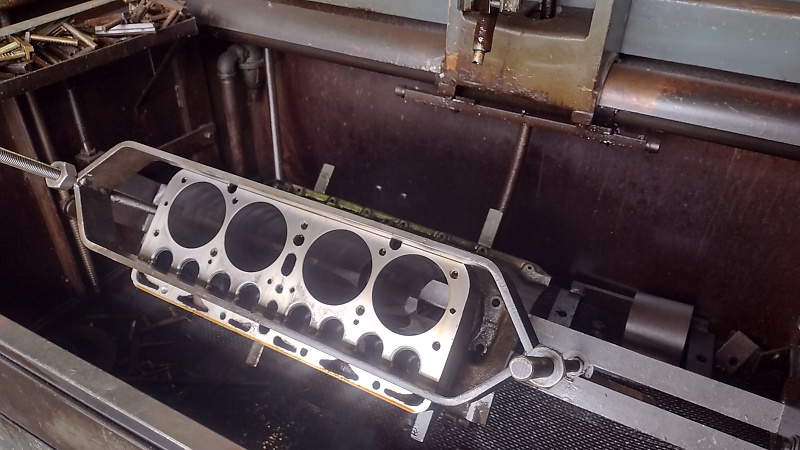

The final honing station. He wanted to check the piston size compared to the bore. Basicaly .003 inch clearance:

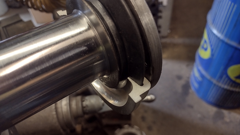

The new thrust washers, bronze material, and the new replaceable bearings which replace the babbit material.
Rubber rear seal slipped over the end of the crank:

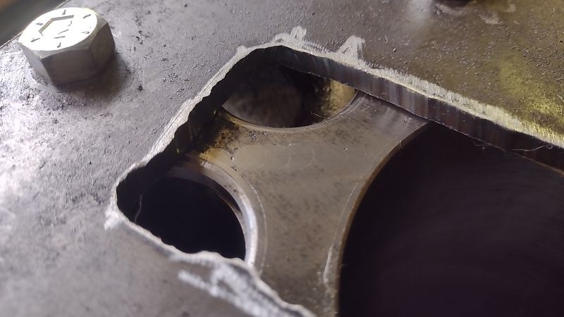

Pressure tested the block to 60PSI (normal pressure is near zero PSI):
Only very tiny air leak where he had to do a repair. It will not leak with water.
His window through the test plate to see his stitch repair work.

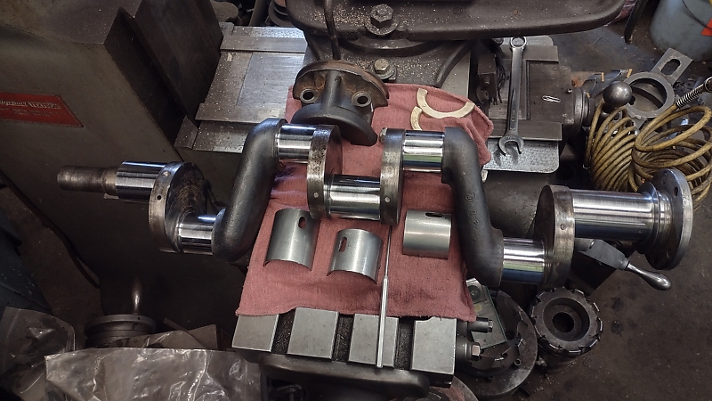

Tim set the new woodruff key and pressed on the new crank gear for me. Crank looks really good to me!

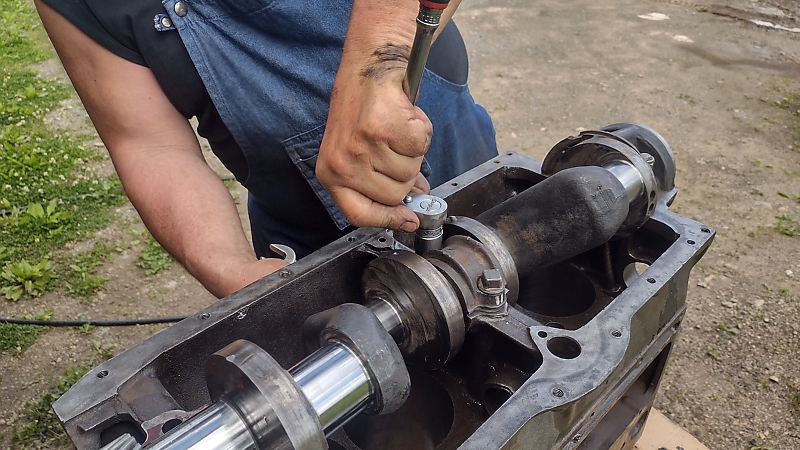

Crank mating up with the block for trial only. I have to do some fitting to get the new upper real seal, aluminum part, to set correctly in the block:
All components are back home. Much cleaning and then assembly can start when we get back from the V8 Club Eastern show.
I am tired just thinking about it! But looking forward to building this "B" engine for the ragged ol truck too.
By the way the crank spins very nice with the caps tightened down. The end thrust clearance is about .010 inches. I like the new rubber rear seal concept and the replaceable bearings with line boring through the block and caps. Took a while but should be a good engine for a long long time.
Tim Waid, Valley Machine Blooming Valley PA. He is very busy but can do Model A or B engine work and repairs. He does have a metal spray machine if needed.

Nothing like a "B" crank picture. Not a balanceed one. will see how it runs.

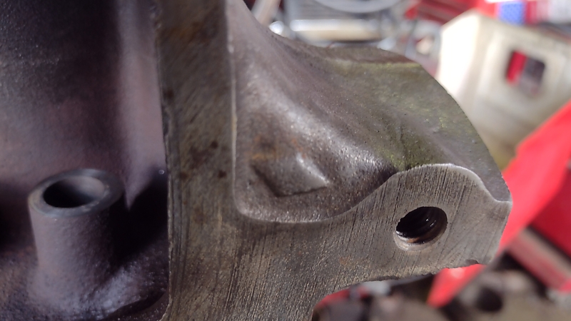

I seen Nate mention this indicator cast in the block. A diamond. I believe he had information that dated it at 1938 or newer? I was a little suprised to find it. Just another tidbit of the story behind this old truck and its back story.
Good news is this block does not have any current water leaks.

Originally Posted by sugarmaker View Post
Folks,
Thanks for checking in on me and the ragged ol truck project! Hope things are good in Ford land!
Regards,
Chris
Chris,
Below is the link where I found my information. There should be a casting number on the passenger side of the block and the chart in this link shows how to read it. In my research some claim diamond blocks to be more desirable because of better casting material/updated molds. Others say that is false and they used the same molding and specs as original. Either way it’s what we have!
Happy reading,
Nate
http://www.fordgarage.com/pages/diamondblock.htm
