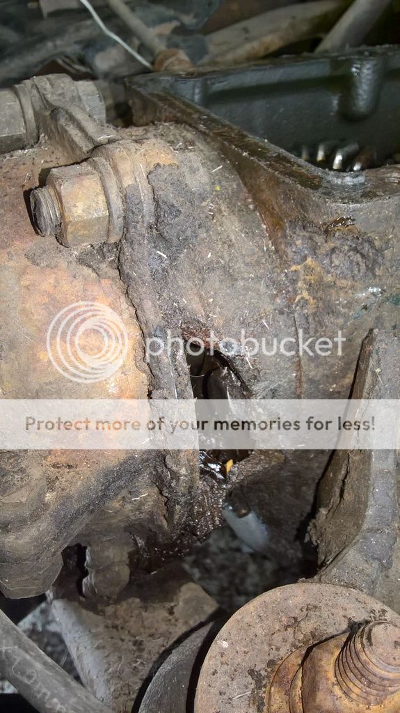

So the number on the back is 78 7006.
After cleaning all the dirt/grease off i could see the right mount is broken, unfortunatley. Moved it out the way for the photo. Can it be fixed as I guess finding a bearing retainer/mount wont be easy?

The rear bearing retainer should be an easy find. Buy the one for the vehicle and not the transmission. Check with Mac VanPelt or Charlie Schwendler.

I have some good used rear transmission mount/bearing retainers for most years, 32-48. Send me a pm if interested.
