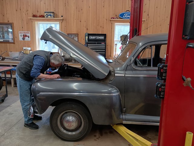

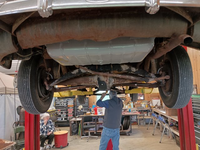

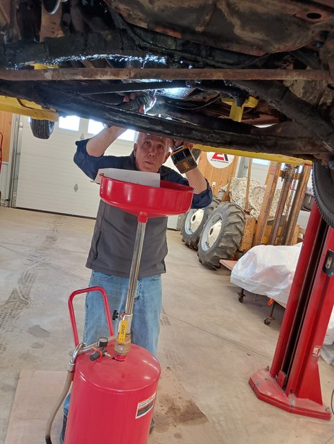

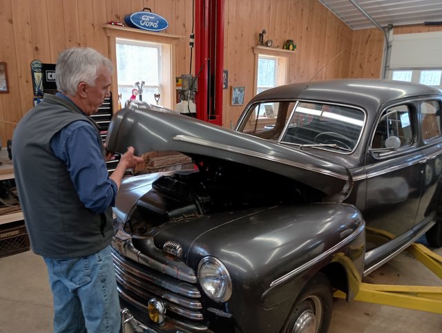

Ford folks,
As we get some better weather, John and I are starting to get our cars out.

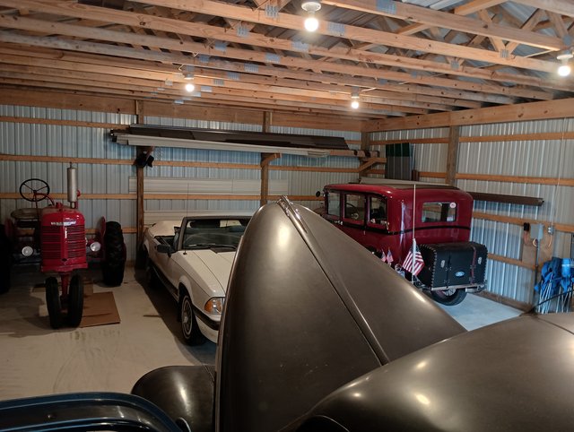

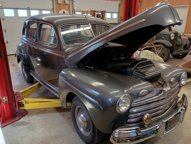

John brought "Howard" up for a oil change. Here is a walk around as the 46 is on the lift in the shop.
Regards,
Chris and Cheryl

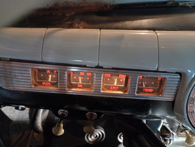

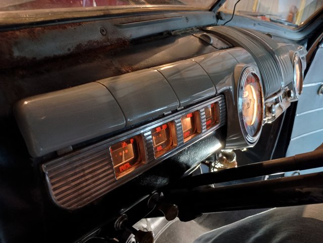

John had a project on Howard. New amp gage install. I arrived when he was almost done.

Pictures coming thru fine. That was a NOS gauge, but you never know until it's installed. Every indication I had was it was charging good, but the amp meter was dead. I'm not a perfectionist but I like anything mechanical to work.
