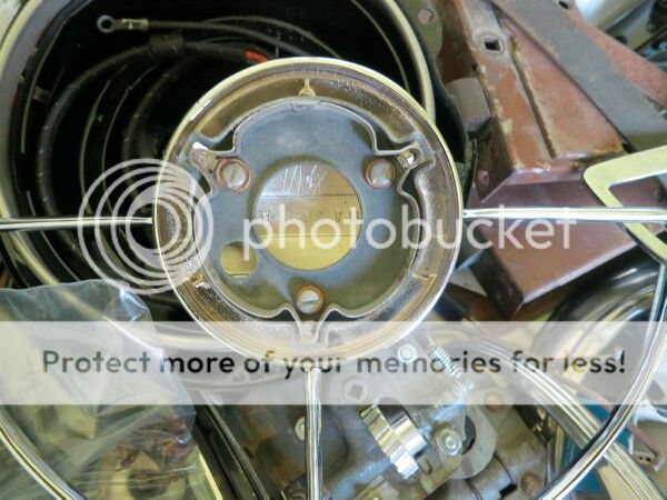

Hope this gets in , my second try. How do I remove the horn ring on steering wheel without damaging it? I need to check if something is making horn short out. Also, does anyone know of written instructions to replace the horn wire in case necessary? Appreciate any help. John

Remove horn ring by pushing and turning, spring not pictured

I tie a string onto the lower end of the horn wire. then if wire gas too be replaced attach the string to the new wire and pull thru. May have to push the horn ring center kind of hard, turn CCW to remove.

Hello JSeery, thks for pics, the 1941 is different I took apart today has spring about 3 inches long, wire looks new so I'm thinking problem is up in horn button area , still working on some insulator parts were hand cut but I ha be original l . Tomorrow will try and resolve john

That's exactly what my insides look like. However I need to know how and what parts go in this horn ring. I put a new insulator around the horn ring the end there's a wire that assembles to the ring coming from steering column, then the spring fits inside that large hole in center with other end of spring onto steering wheel. Horn works if you press one side or bottom due to the new insulator that goes around inside that outer cavalry in horn ring. Horn will blow then it gets blowing continuously. Should the spring be insulated on each end so it doesn't make contact with any metal? I don't think is the wire as it looks new, could it be relay? How to test relay!.? John

The relay could be sticking. Might try disconnecting the ground wire to the relay. Then connect the battery and see if the horn blows with the ground wire (the wire to the steering column) disconnected. If it does not then try touching the ground wire to the relay post and see if that activates the horn.
