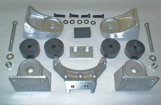

31 pickup.... last fall I bought a fam kit from a guy at an antique engine ant tractor show.(a bargain aint always a bargain) it was in the original box and I got it for a good price. I installed the engine today in the bare chassis. every thing went well till I got to the rubber block. there is a package of bolts and nuts still sealed and a piece of flat bar with two counter sunk holes but no yolk or what ever is supposed to be there. the directions don't have a picture of the rear mount. is this rear mount really necessary? if I knew what the yolk looks like I could probably fabricate one any suggestions.

Rear mount instructions;
http://www.snydersantiqueauto.com/Co...AMNEW-9533.pdf
Picture of all the parts that are supposed to be in the rear kit.

yep! it looks like I got everything but the yolk. anybody got an extra one laying around? I know the guy I bought it from and I may try to contact him and see if it just got out of the box and may be still be in his stuff.
that might be hard to fab up.
