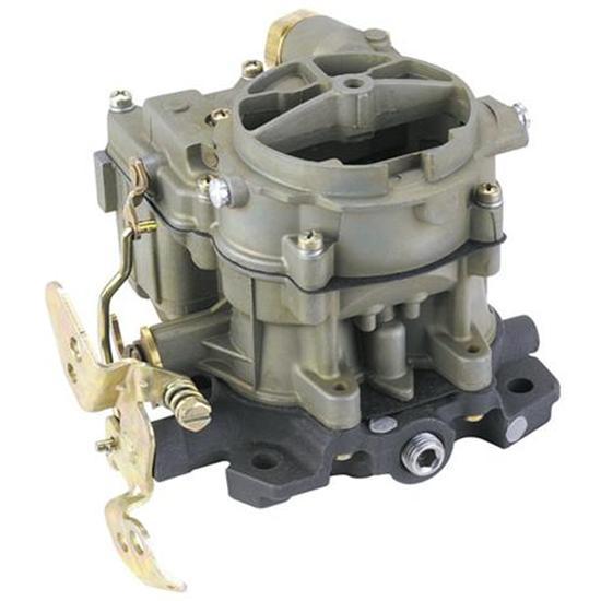

would this be the proper carb to use on my flatty , with manifold to go with it?
thanks kurt

I looked this up on the web, and Jeg's says it is a large base Rochester 2G. The large base carburetors will not fit the Mercury 4-bolt manifolds we all like so well. A small base 2G will bolt right on. The bores of the small base are 1 7/16" which is quite a bit larger than the merc manifold. I bore the manifolds to match the carburetor and have never had a problem breaking through. I don't know if that would be the case with the large base series.
You really want a small base 2G for this. To be specific, you need one from a Chevrolet because of the side placement of the fuel inlet that is just about where the stock inlet is located and allows the use of the stock fuel line. The other carbs (like the one in the picture "petehoovie" posted), have the fuel inlet pointing forward, which requires a much more complicated fuel line.
FYI : The small base bolt pattern is: c-c 3 1/4 x 1 7/8 inches, while the large base is: c-c 3 11/16 x 2 1/16 inches). There are adapters available, but they are expensive because the sizes are so close. https://www.dashman.net/category.php?id=32

Four small-base Rochester 2G carburetors, two side inlet
https://www.jalopyjournal.com/forum/...inlet.1249134/

That ad clearly shows the difference between the fuel inlet locations. Too bad it's over 2 years old. Sadly, I have found that inflation has hit the small base 2G market harder than most other things.
