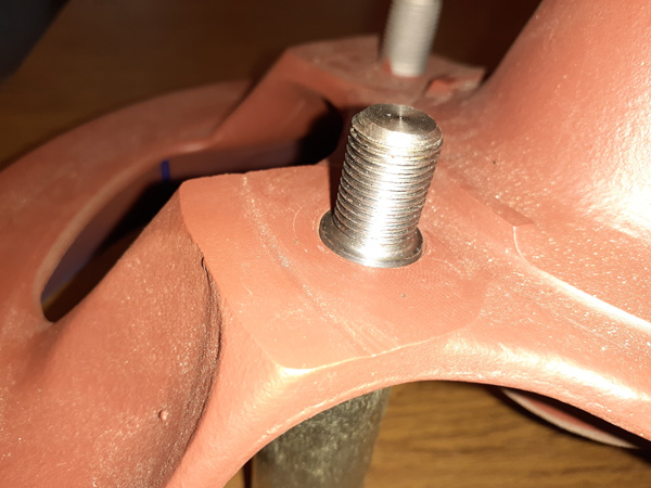

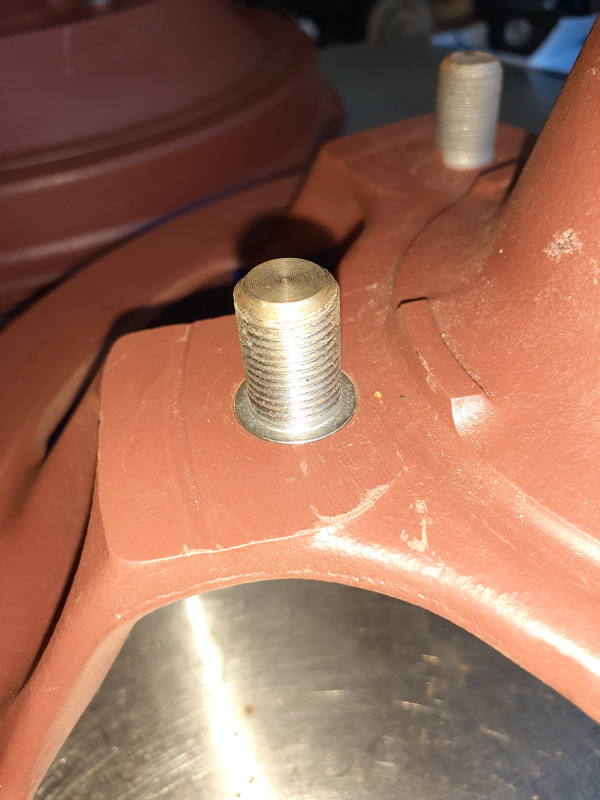

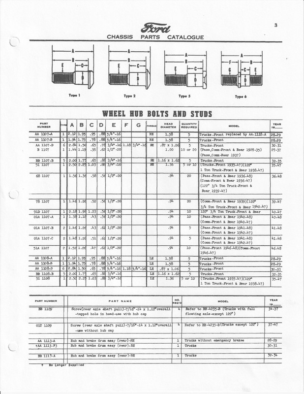

I've had the same problem of finding front wheel studs for a 34. The #B-1107 studs sold today are not correct. Either in overall length, or in the shank length that gets swedged into the drum. The overall length is too short to have a nut completly run up on the stud. The shank is too long to swedge.
Here is the Ford Chassis Parts Catalogue with the correct dimensions:
This is what you will find using the studs on the market that "say" their for a 34:
Can't swedge those!
I found a Model T Rear Hub Bolt #T-2888 is a much better alternative for the 34 front drum.
Their overall length is good, and the shank is perfect to swedge:

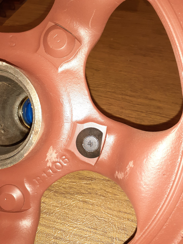

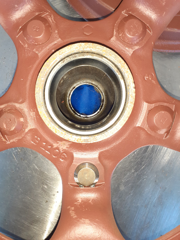

One point though. The B-1107 studs and the Model T studs both need a little help on the rear side to fit the drum shoulder. The heads are too small. Here is the market studs sold:
What I did is spot a little weld on the corners of the T-2888 (which fit better than the B-1107) and ground them down to fit tight against the drum shoulder:
Good old Model T Parts never hurt anyone!!
