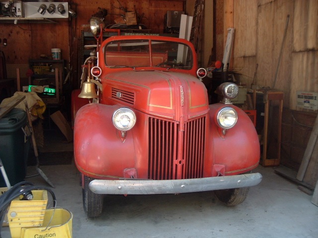

Our local Historical Society has just received the donation of a 1946 Ford Fire Engine. It's an open cab model with a Howard Cooper fire engine body on what looks to be a 1 1/2 ton Ford truck chassis (w/b is about 132"). It was sitting in a field for the last 10 years; we're trying to get it running and registered.
We have several questions....
1. This vehicle has never been registered (since it was owned by a Fire Department) - where would we look for a serial number? Somewhere on the frame?
2. How can we determine what model the chassis was before the fire engine body was installed? I'm guessing it's a 1 1/2 ton; it has huge wheels 7.50x20 and dual wheels in the back
3. Is there any service manual for the Ford truck chassis?
Does anyone know of another 1946 Ford open cab fire truck/engine that still running?
If you're interested in seeing what we're doing with this project, here's a quickie web page with some "before" photos.
rickblack.org/FireEngine
Any help will be appreciated.
Rick Black
Southern Oregon Historical Society
Medford Oregon

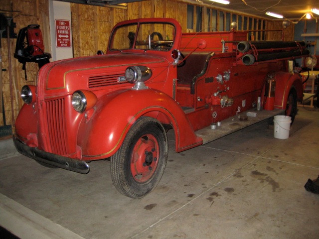

Thanks for the info. Here's a photo of the windshield. It looks like a Model A Ford shaped windshield. And there's a very strange electric wiper mounted at the top - so far, we haven't figured out what it is. But it's NOT a Trico.
Would love to find a chassis manual; we're going to need to do a tune up, brake job, etc. Nothing to go on except a Motor's Repair Manual, and those don't address commercial vehicles.

military steering wheel, definitely a local mfg windshield frame, looks like two controls to operate the pump, pull up from floor and an extra lever near brake arm, lever could also be a splitter box (over/under drive) located in drive shaft for more pulling power or speed. pictures of that attached, by the way also sent a picture of a converted fire truck, must have been sort of ladder/ariel truck. will check on manuals for you.
