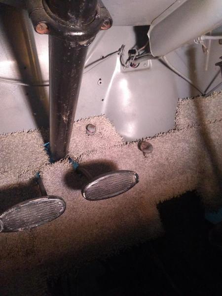

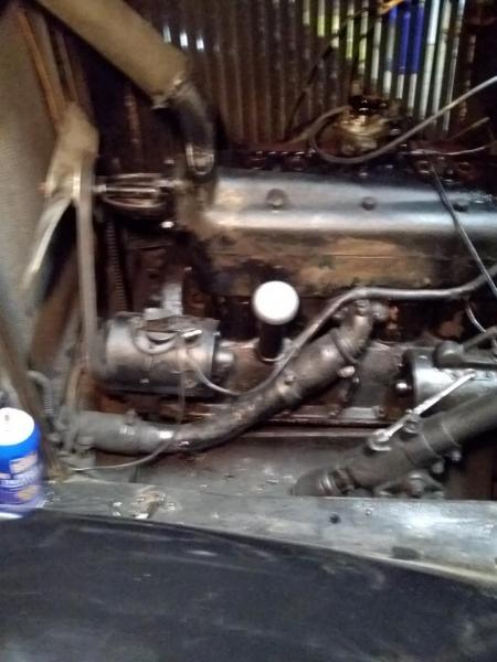

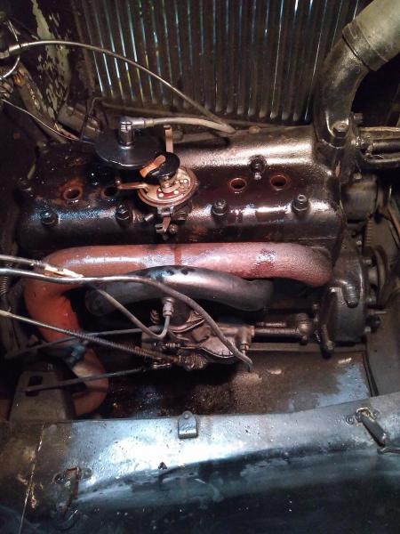

I finally have Pictures of my Sedan 1930 Briggs Model A
This right ? LOL
OK, many have asked for pics that they might be able to help me with this stuck engine.
I am still digging into this machine, and I find she is very much original...wood?
Bad seat cover over originals. Look for the wood behind the rear seat. and around window. You guys know better than I, so let me know if what I am seeing is true.

I can see them. The picture of the motor and motor/head paint may indicate a head gasket leak in the cylinder 2-3 area. If yes and water made it to valves/pistons and then sat, they may be rusted to the block. Check motor oil for water.
Looks like there is/mav have been an issue at the Water pump, Bad Water pump Gasket, or packing Nut leak, or upper hose neck /head gasket leak.
If unable to get motor freed up, most likely the head will have to be pulled.

Looks like a standard Fordoor that has been uh.....'upgraded'. I can't tell about the wood but if you poke at it with an awl and it doesn't go in very far then consider the wood good. However, the whole body is made of wood, roof, top, doors sill etc. Do the doors sag at all? Do they close nice and tight? You have a "fairly rare" car as many Fordoors got turned into Townsedans so there are not many stock Fordoors left.
But the Body looks nice and straight, dent free and solid. So, outside of the engine I think you have a winner. Don't forget to check over the brakes and front suspension.
