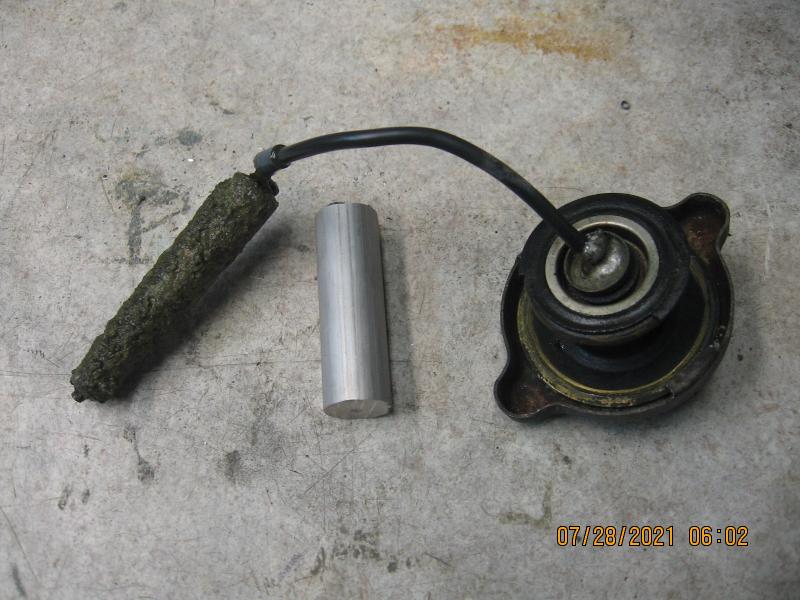

In August of 2020, I started a thread about sacrificial anodes in the cooling system : https://www.fordbarn.com/forum/showt...ighlight=anode. I went ahead with it, and in July of 2021 when checking the coolant level in my '51, I removed the radiator cap and was quite surprised at the amount of deterioration it had undergone in a little less that one year. The attached picture shows the anode as removed then, and a new chunk of magnesium I replaced the initial one with. The cooling system on this engine was scrupulously cleaned when it was installed 7 years ago. After a manual clean and flush, I ran an Evaporust process 3 times to make sure I had everything out of it.
I sort of forgot about it last year, but I had occasion to check my cooling system level today. When I removed the cap, the anode I had put in new in 2021 came with it and I was shocked at what it looked like after only two years. The other picture is of that anode; remember, this is the NEW chunk in the other picture as I had discarded the eroded piece. In light of this, I think I'll be checking and replacing them every year. |

Magnesium seriously corrodes in hot aqueous media all by itself yielding hydrogen gas & milk of magnesia. So its level or rate of corrosion doesn't necessarily reflect how well it's protecting other less electropositive metals. Coolant corrosion inhibitors that passivate the surfaces of other metals like iron & aluminum are probably more effective.

I am also a fan on "No-Rosion" and bought a case of it several years ago. I quit using it after switching to sacrificial anodes, mainly because of cost. My rationale behind using sacrificial anodes is quite simple.The ones I use are made to be used as sacrificial anodes specifically designed to protect aluminum tanks in RV water heaters. I don't think they make any of those without anodes. I guess I am just relying on the expertise and years of experience of those that are charged with making those systems work. Over the last 65 years, I have run across many finned aluminum high-performance heads that were rendered unusable by excessive corrosion. I don't want that to happen to any of mine, given their cost and scarcity these days. |

In my 35, I run Prestone 50% and have fitted ZINC anodes into each bank. I change the antifreeze solution every 5 years or so, every 10 years i replace the anodes. They show some deterioration after that time. However, and most importantly, The Eddie Meyer heads are as good as the day I fitted them. An easy way to make up anodes for a 24 stud engine that has 3/8 tapped holes each side of the top water outlets in the heads [that take temperature sender units], is to get some brass 3/8 pipe plugs. They have a blind hole on the inside. tap that hole 1/4 pipe. Zinc rod is available in 1/2" dia. Cut a piece of said zinc rod about 2-2 1/2" and thread one end 1/4 pipe. Screw the zinc into the brass plug. You now have something that sorta resembles a sender unit. Fit it into the 'spare' tapped hole in the head. Externally, it just looks like a stock plug, but it's doing a vital job. One in each head will do the job nicely. Will protect those valuable heads perfectly!

I didn't know that. Looking at the periodic table, I always 'thought' Magnesium would make a better sacrificial anode, but I've only ever used zinc. And, as above, it works very well in protecting aluminum heads.
