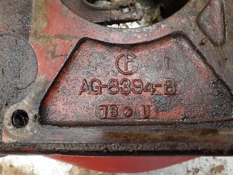

Hey, could anyone here help me identify a Ford Bellhousing?
The Casting numbers show AF6394-A I got it painted in “red orange” making me think maybe that it comes from a Y-Block Thanks and I hope we can find this information |

There should be a date code below that part number cast into the bell housing. There is one fr sale on EBAY with that part number

. AF6394-A What is the date code just below that casting number? The first digit might be a 6 or 7... . Last edited by dmsfrr; 09-11-2023 at 12:45 PM. Reason: add photo |

I saw that and it didn’t seem like the seller knew the exact application
The date on mine is 58-P I believe. |

do you think the picture I attached helps you at all?

Post a picture of the whole bell. It really doesn't make much difference on YBlock bells, pretty much the same. Trucks were different from the sedans.

Just checked my '54 239/Auto. Not the same.

Bottom of page are the car casting numbers.
http://www.ford-y-block.com/t5in-cars-bird.htm Picture and casting numbers for trucks http://www.ford-y-block.com/t5in-trucks.htm |

Pictures are here

Here are the pictures of the Bell Housing in question

Looks like the standard stick shift bellhousing. Used behind all the CAR (including TBird) engines, 272, 292 and 312. Wouldn't be surprised it fit a 239 and 256 besides. Not a truck bellhousing.
If the date code shown above is correct, then it most likely was used in a 56 (car or Tbird) since August was usually a change over month for the new models. Possibly used in a 55 if they were still building 55 models then.

that is a 223 bell.the 2 top bolt holes are to close together.
