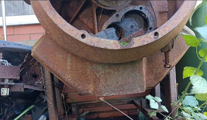

Can anyone identify this Unusual Flathead V8 Engine?
Notice the Welsh Plug on the rear of the Block just under the Head

Interesting. I think it is Ford Pilot engine, those had similar plugs rear of the block?

"Pilot" type, as probably British. The oil filter wouldn't have been there, though, in any normal car or truck application, so probably either military industrial usage. I just went outside and checked an English block and actually it does not have those plugs. I looked again at the pics and the engine in the pics has the Pilot type coil bracket.
So yeah, probably Pilot, but not all English 21 studs have those core plugs.

Ford Pilot Block without the Welsh Plugs next to the Heads - Mart
