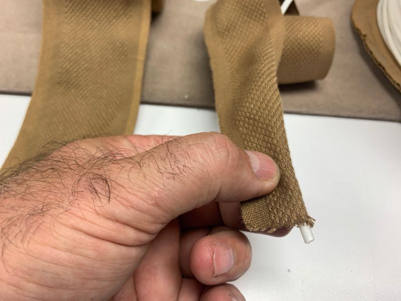

We do. We make our own Windlace and Coachlace. I am in talks right now with a weaver about having the correct pattern material made for Windlace and Coachlace. . . |

That looks nice Brent. Do you sell to the public or just use 'in-house' on cars you restore?

I made mine on my early '28 Coupe just as Brent is making his. I used 3/8" vinyl tubing and died the coacklace to match the coachlace trim on the top of the door panels.
