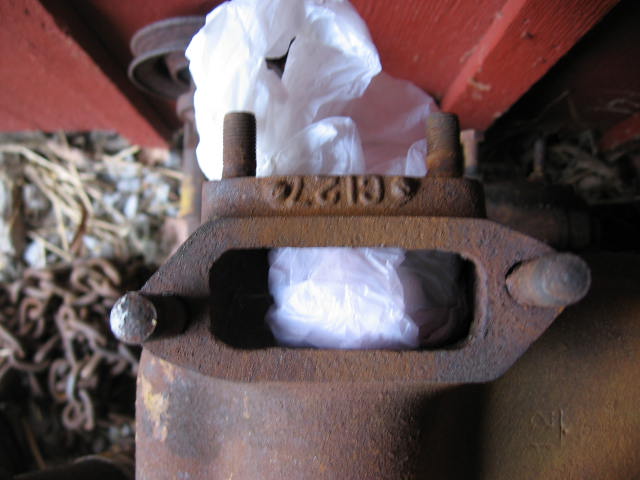

Bought this from a lady who was using it as yard art. I'm not familar with Model A engines (Model T guy). Can you help?

It just looks like a Model A engine. It might be a later replacement engine. Diamond block.

Is there a number stamped on a pad on the left side of the block just below the head gasket.

Tractor motor??? Note the idler pully

good EYE
Is that way the oil tube looks so big |

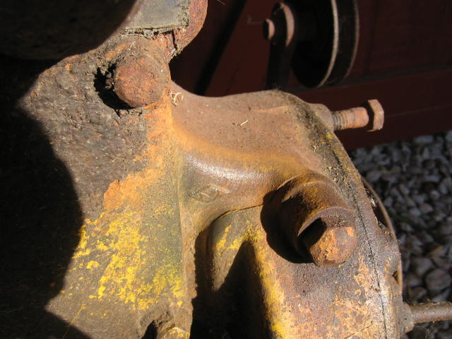

some additional phots, not a B engine. Serial # A4869984 and is a diamond block. I assume its' an industrial engine. What is the significance of the diamond blocks? Thanks

The diamond blocks were made after stock production ceased. Some theories are that they have thicker castings, but this is disputed often. The usual difference is that diamond blocks were often used in industrial applications and often have hard valve seats.

Looks like a Model A engine with an aftermarket script head.

How can you tell a diamond block from a standard "A" block? Is there a diamond cast into the block or something? A diamond in the serial number?

I have several heads identical to what is shown. They are Ford built heads cast after the A went out of production. Just in front of the water outlet you can see a date "tag" cast into the head. Gar Williams

[QUOTE=Is there a diamond cast into the block or something?
Thanks[/QUOTE] See the second photo in post #7. the <> is horizontal.

Gar, in the Model A Judging Standards, Copyright 1981, on page 1-1 at bottom Right, it says. "Quote" Most cylinder heads had no Ford script and few, if any markings. Ford script heads are acceptable through mid 1928 only. After mid-1928, Model A cylinder heads had no numbers or letters on them. Other after market heads will appear identical to the factory original heads, except they may have raised bosses with numbers or letters. "End Quote" Ford was real touchy about someone using the Ford name on after market parts. A good friend of mine who lived in Omaha, Mel Alexander also told me that those heads were Model A AR. So if that ford script is not Early AR, what do the Early AR's look like, as that head is the only Model A head style I have seen with Ford script. If I am mistaken, I would like to find out, I am going to keep digging in my Model A books, and see what I can find, give me some help Guys, see what you can find. thanks Gar, Herm. |
