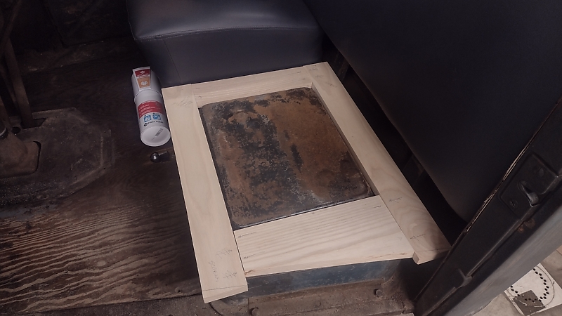

Some shots of your drivers seat frame as it starts to take shape.
Test fit on my gas tank. I know your a ways from needing this to go down the road. Just trying to keep things moving for you.

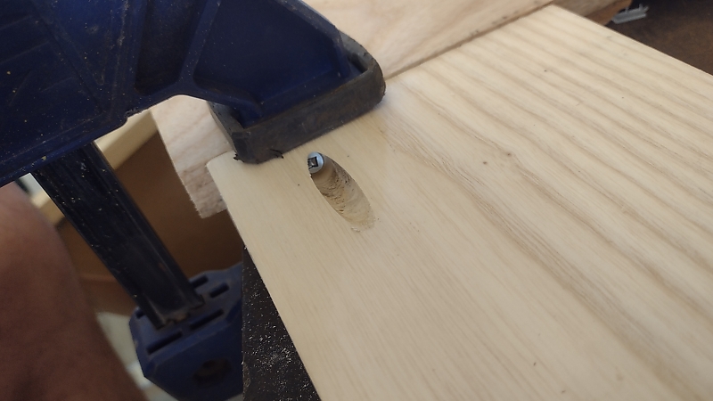

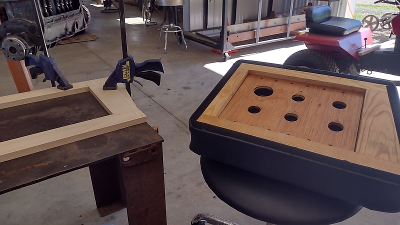

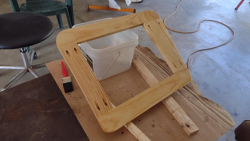

Began assembly of your drivers seat frame. Man I hope this matches the one you have!
Kreg pocket screws with glued joints:
Prototype here:
Another mock on my truck tank:
New DeWalt sander worked very well:
The finished product:
