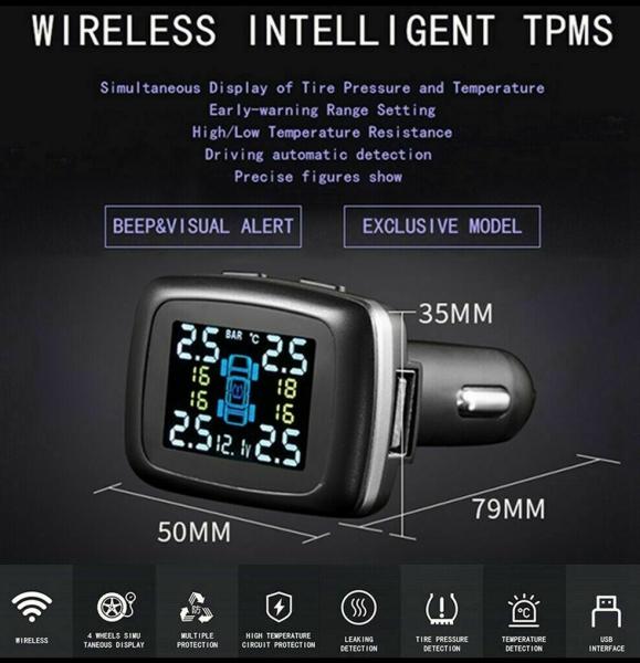

Al in new york
tell us more about tire pressure sensors on your tires? mainly how do they sence the pressure
tuneman is offline   Reply With Quote
Old 11-27-2020, 05:16 PM   #79
AL in NY
AL in NY's Avatar
Location: Southern Upstate New York
Posts: 1,162
Default Re: 16" Wheels
tuneman: I purchased an after-market TPMS that plugs into a cigarette lighter. I chose one that a knew worked on 6 volts. Because I am using 35 Ford 16 inch wire wheels, the included valve stems are too small in diameter to fix the 16" wheels. I had to modify the larger metal valve stems to take the mounting ball from the TPMS valve stems. The pressure is sensed with a wireless connection between the tire sensor and the receiver. The TPMS system I purchased also tells me the generator output voltage.
