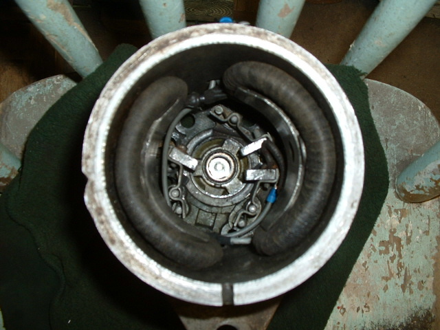

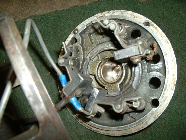

Please post photos of your brush plate and the fields inside. If you are using a later vented brush plate, these have 2 alignment pin holes. If you are not using the correct one, the brush position will be way off.

I made a mistake, the rear plate is perforated, I just hadn't paid attention to it previously.
Here's the pictures you requested:

I can't see the output wire, but it looks like the fields are wiired wrong. I noted on your photo where the field wires should go. Also adding a photo of mine showing these wires. The positive brush should have its own high strand count, 12ga wire going to the cutout.

I've tried the field wires connected both ways and no joy. A magnetic polarity check (as per https://www.fordbarn.com/forum/showthread.php?t=71055) says they are correct as they are connected.

Hi All - Katy and I had a look at his Generator using my generator test stand. As Steve noted above, the coils were wired backwards. With that fixed, the generator would still not run - it was actually drawing 5A rather than producing 5 Amps at the lowest third brush setting. After scratching my head for a while, I swapped the armature from a good generator and it worked properly. My guess is there was a "flying short" in the armature even though it apparently tested well on a growler.

Well done Mike, thanks for the follow up. I knew the field wiring was wrong, but when compounded by a bad armature, troubleshooting is difficult. I have seen a few flying shorts, they can be hard to diagnose. Good job!
