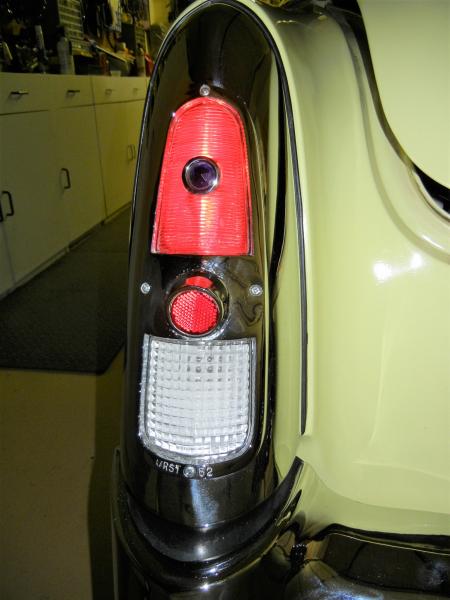

I have the "Hyper Flash" situation, so my question is rather than putting a 50 watt 6 ohm resistor (or any resistor) on each side, why not just put a single 50 watt 6 ohm resistor on the load side of the flasher? Or am I over simplifying?

Interesting. When I solder two 1154 bulbs together and use the flasher, it works perfectly (correct resistance tot he flasher). But when I install it in the car, where most of the bulbs have been replaces with LED's, it flashes way to fast. That would seem to say I need something that would simulate a higher resistance (wattage demand). Hence the reason I was asking about putting a 50 watt 8 ohm resister between the load side of the flasher and the turn signal switch.
Do you have a mfg and flasher number?
The first picture was a bit too generic. Thought I would add a few more, vehicle specific.

Not sure about the "Synchro909" but in my 53' Merc, the brake light, turn signal and tail light, are all one bulb.
