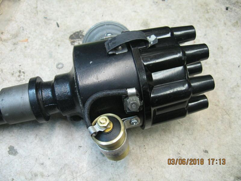

Here ya go from the bench today ........
02-14-2021, 01:27 PM | #28 |
Location: SPEEDWAY INDIANA
Posts: 4,148
Re: Harmon Collins build thread ...
Some condesnor work today , bracket dimentions in previous post answer ..
The Collins is a very good example of two 4 cylinder systems , we are using the 3.0 ohms Bosch blue coils and two Vertex Magneto condensors ( these are the very best condensor available today ) My friend owns a very serious racing magneto business and has these made ( high quality) to service his customers . They test at .36 mfd and use a soldered end ground which makes them bullett proof !! Note the connectors are NOT soldered , he claims a crimped connection is better than soldered one as solder will vibrate and break !!! |

condensor pics collins
