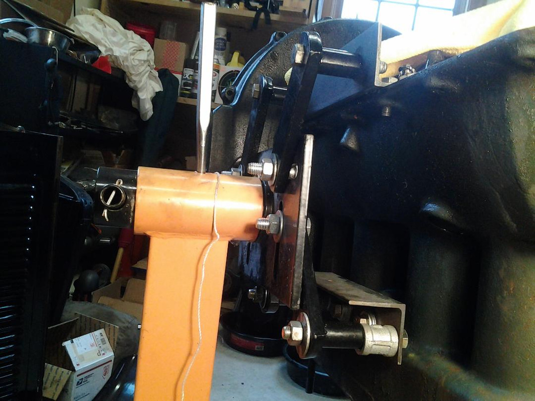

Here is my version, just using angle iron, pipe couplings, and bolts. I wish I had greased the rotating part of the stand after it sat for 9+ years.
I think that it could be simplified by bolting the pan rail angle directly to the plate and have the water outlet bolts with spacers go through the lower arms, with the arms bolted on the backside of the plate, if needed.

I use Snyders adapter and a 4 WHEEL STAND-as mentioned ,very important.
I have had the long block plus clutch and transmission on the stand and never a problem

My last comment is pretty much like the post#6 pix.
