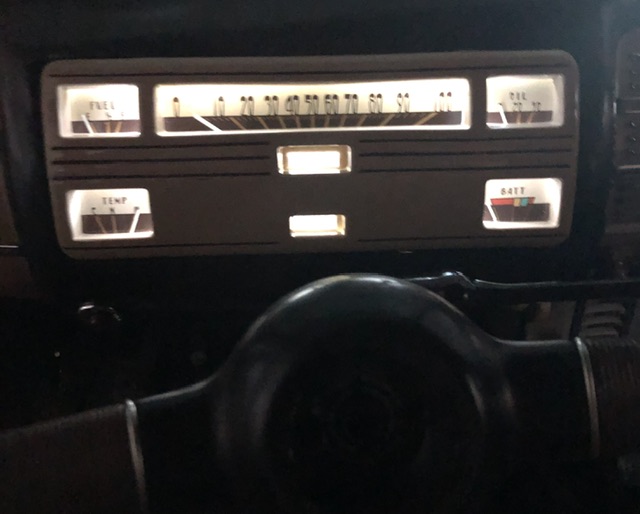

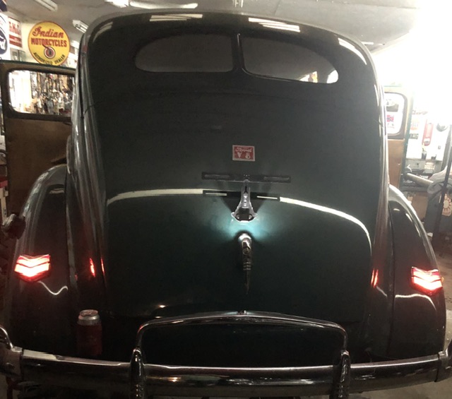

Yes, got them in my 40s.

What!? They have LEDs that fit dash light sockets!. Do they have 12v positive ground?
Unless the sun is over my shoulder, I have to use a flashlight to read the gauges on my '41. Maybe because of low contrast between red needles and gold/amber instrument face. Maybe because I need cataract surgery.

Don’t know about 12 volt. Mine are 6 volt and fit in the sockets just fine.

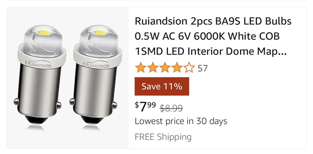

Got them on Amazon .
