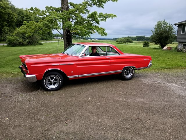

Here are some recent pictures of our lil red Comet. Cheryl has been so patient to allow me to work on it for hours. With Johns help we installed new rear leaf springs, installation kit and conventional rear shocks. The goal was to set the rear of the car about the same height as when the air shocks were pumped up near the max. The air shocks which were on the car when we bought it. They worked but did leak down over winter. I did not want them to fail and let us down on the road.
So in my infinite wisdom, Ok a best guess, I ordered new leaf springs from Eaton. I specd 2 inches higher ride height. They raised the back of the car more than expected. maybe about 4 inches.
Oh yeah pictures.....
Yesterday (mothers day) we went for ice cream up near Lake Erie and then to Raccoon Park about 3 miles to the west. Right on the lake.
Cheryl like the ride and the AM comett radio had to be called upon since there was not cell reception:
So today's project was to put the old 225-70R14 tires on the rear of the car. Yep that made it even higher!
John helped me get these on and stretch the new springs again.
The concept here was to fill up the rear wheels more than the 235-60's.
Regards,
Chris and Cheryl
No reason for that. Did you get back to EATON?
EATON was the supplier to FOMOCO and have all of the spring ratings.
They offer stock or modified. If nothing else, maybe lowering blocks?

folks,
Atch, yes they di raise it more than I expected. May live with it/ Its not a bad look and with the front higher it sets pretty close.
KULTULZ,
I did get back to Eaton they are very knowledgeable. I asked for two inches higher than stock. If you look at the brochure pictures this is about 5 inches higher.
They said to push the spring eye back to get the shackle angled back. Doesn't work on these springs More arch in them. I may call them again.
Also Local spring shop could de-arch them if needed.
I am not loosing any sleep over it and several folks at shows have said leave it alone they like it.
Got my new Merc Man hub centers from Auto Krafters. They should work fine!

Folks, atch,
We are still driving the Comet. With Johns help I did tighten the adjustment on the Comet steering box a 1/4 turn and it did tighten up the slop in the steering wheel. Keep tuning! Keep driving!
Have spoken with Mike at Eaton and they are building me a new set of springs with less arch and slightly longer. We will see how those set the car. Looking for something near 24 inch dimension at the rear wheel well.
Last night, John and his wife in their nice 55 Club Sedan. We crusied to the ice cream stand and then to a park on the lake:
This is from last week in Erie:

KULTULZ, folks,
The look is just a tad higher than I would like and the ride is pretty harsh. Mike at Eaton is working on design improvements to the rear leaf springs. The dimension I am looking for on the rear is about 23-24 inches from floor to the rear wheel well. We shall see.

Guys,
John helped me put the redesigned rear leaf springs. It reset the rear of the car about 1.5 inch lower. Shackles are more in the slight rear direction as desired when we set the weight of the car on the springs. The shocks now have a 1.5 inch of stroke. That should provide a much better ride.

I forgot to mention as to shock travel length/stroke/mounting needing to be modified if a car is lowered or raised. Bad things can happen.
Now Miss Cheryl will not have to worry her ice cream may fall out of the cone if hitting a bump in the road ...

Guys,
The look is fine. The shocks should function better now. We took the Comet to a cruise in last night. The ride was good. But there is a problem somewhere in the drive line. turning to the right there is a grinding noise? We had to leave early due to not feeling well. Kidney stones. These things are nasty! Better this morning. Will do some testing and evaluation on the Comet noise. Sounds like the noise is from the rear??
