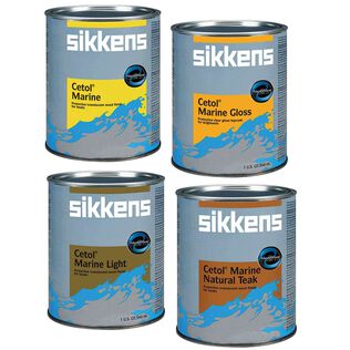

I also used Sikkens Cetol Marine finishes on various areas of my wood Lyman boat. Easy application and easy to touch up.

Be careful. Most Cetol has pigment in it. It also takes about 2 days to dry. Epifanes does as well. It used to dry overnight, but they changed the formula a while ago.
