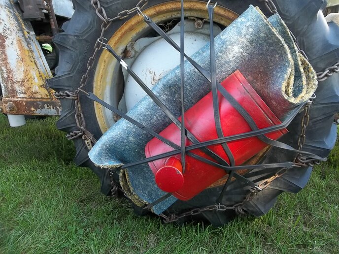

Strap your tank to your tractor wheel. Put a couple of short lengths of heavy chain in the tank with a couple of gallons of kerosene. Go plow the north forty for an hour or two. Tank should be really clean inside by now.

That's called 'Killing two pigeons with one rock'. The best part is the phenomenal length of time you get to COMPLETELY slosh that tank around a full 360º, in three planes no less, while not even breaking a sweat like you would just standing there and shaking that tank by hand.
