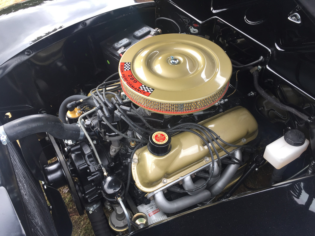

Old 03-08-2024, 02:02 PM   #16
Henry Floored
Henry Floored's Avatar
Location: Florida
Posts: 611
Default Re: Cadillac 331 in a Ford
Henry Floored is offline   Reply With Quote

Old 03-08-2024, 02:01 PM   #18
Krylon32
Posts: 5,170
Offenhauser used to a good source but since the family sold the business the new owners are not the best at running the business. Availability of parts has diminished and prices have increased significantly.
Krylon32 is offline   Reply With Quote
Old 03-08-2024, 02:30 PM   #19
40coe
40coe's Avatar
Join Date: Mar 2024
Location: Nordland, WA
Posts: 82
Nice install! A Ford in a Ford very nice!
40coe is offline   Reply With Quote
