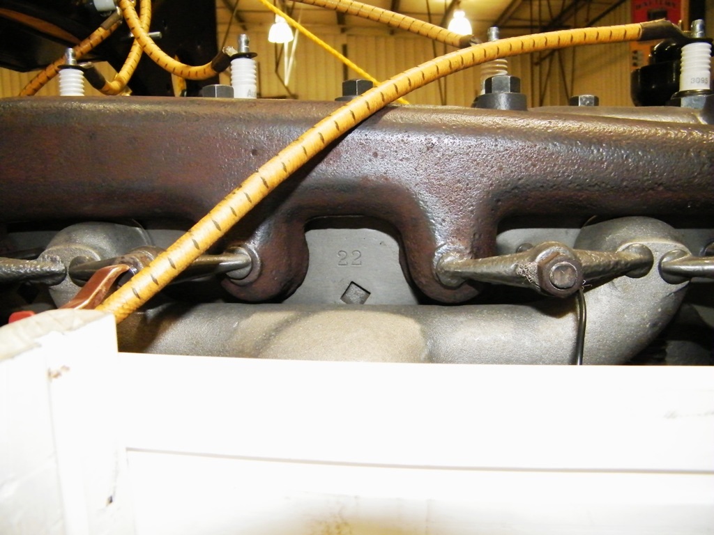

The first 500 or so engines had this location:

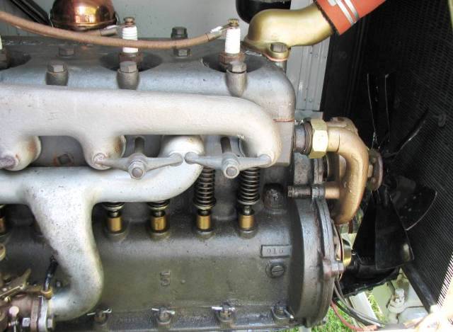

Later, in 1909 calendar year, the raised pad appeared on the right side of the engine just behind the water pump (serial 916 shown):
