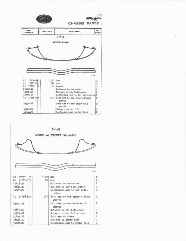

Here's a Ford archives photo that leaves no doubt as to the singularity of the '34 bumper groove.

As DavidG points out, the 34 has a single impressed line centered in its length, painted black.
The 34 Victoria (40-740) rear bumper is different than its contemporaries....longer in length, and more curved at its ends. The brackets are shaped different too to accommodate the Deck Door opening fully with the spare tire attached.
To directly answer your question, the 68-17757 listed above for the 34 is the same for all models of Ford 1935 except for the Sedan Delivery. 34 has a single stamped line, 35 has a double.
